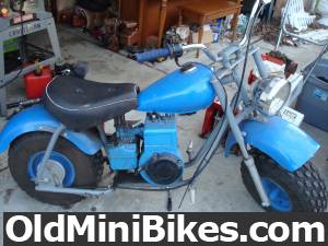

Direct drive it and eliminate the jackshaft plate....you will get comparable speed. And the clutch will not toast as fast. I drove this one all summer and at the track. Then sold it and the clutch is still going. *note..upgraded to Hilliard clutch though. It was 45 bucks at Tractor Supply.
Added clone after this pic....
