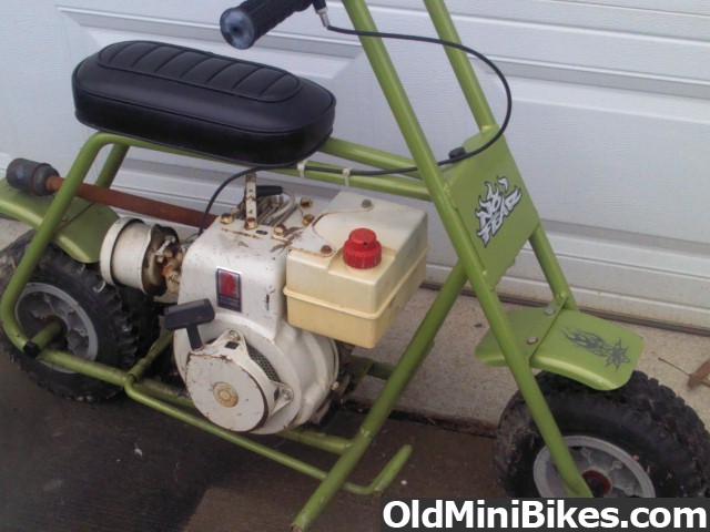

And yes these were Manco made, and they were the 3rd version of the bike that manco called "streaker" Here is the same year sold under the Manco name the one with Kelly Earnhart on it, sitting right about the spot where pop's rolling roadblock went south years later:
If you leave the - out of the part number you can pulled up the exploded view on the sears parts site still, you can usually do that for most of the bke they sold.

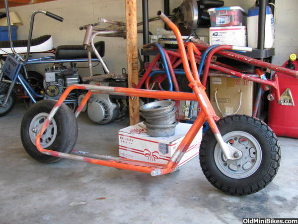

I cut a later built one up for a buddy, you can stretch a few inches without taking the proportions out of whack, just widens the top under the seat. that would help greatly in ridablilty, the later style kicked forward handlebars help as well.
I chopped some out of the center and of course lowered the bike too but you get the idea:
