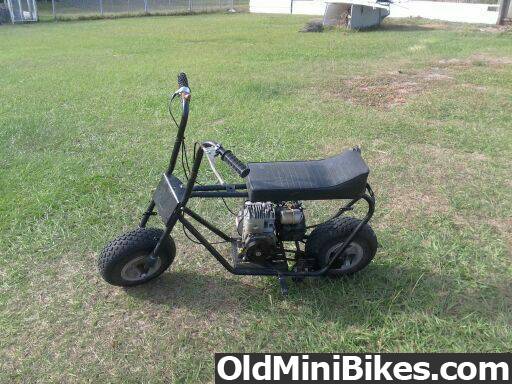

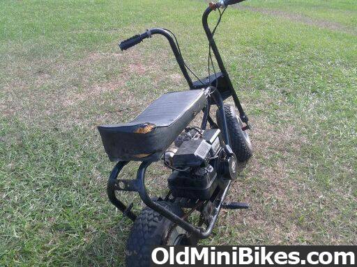

fitting a drum brake will require mounting stop lug onto the frame most likely. For instance this trail blazer below that I had bought to part out a few years ago had Azusa tri stars on it, with the Azusa flat drum brake. Not the best photo's but you can see they welded a 5/16" round spacer/bushing to the frame so the brake stop ear had something to bolt to (right side bottom frame bend). It worked pretty good on the one ride I took it one before it went under the knife :grind:
