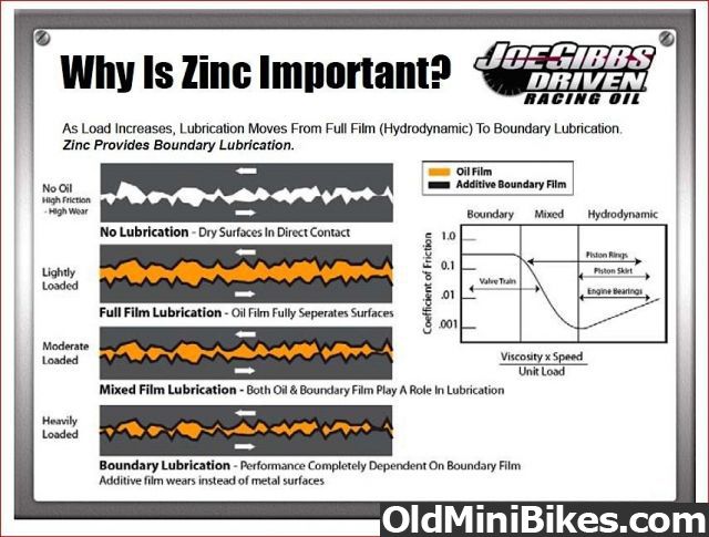

Here is a chart that he used in his presentation.
In the right of the chart is a smaller chart. He referenced this small chart several times showing the 3 lubrication phases of oil in an engine. You can see the left side is coefficient of friction and the bottom is Viscosity X Speed divided by Load or PSI. The top line is the Boundary, Mixed and Hydrodynamic lubrication phases of the oil. It also shows what is lubricated in each phase. The boundary is nothing but additive that have been added to the oil. This is start up when there is no oil flow and the most wear occurring. The mixed is cold operation and the transition up to operating temperature. The hydrodynamic is what he called "full film". This is running at operating temperature under full oil pressure. The point of the oil viscosity transition from mixed to hydrodynamic is the critical point and the dyno testing by Joe Gibbs Racing showed that by just moving to the right of that point on the chart was the optimal point for horsepower and reduced wear. Anything to the left of that point led to "oil pan failure". He explained that as rods through the pan...
2 things that he stressed were matching the viscosity to the engine and using an oil temperature gauge. He said that engine clearances when you are building it determine the viscosity needs. Small clearance needs lighter - lower viscosity oils. Larger clearances need heavier - higher viscosity oils. The oil temp also dictates viscosity. The pump just moves fluid. It does not create pressure. The restrictions in the engine make "back" pressure on the pump. Bearing clearances and the valve train are the restrictions. Squeezing the oil through the restrictions produces heat. So by using an oil temperature gauge you can change viscosity and see the temperature change.
