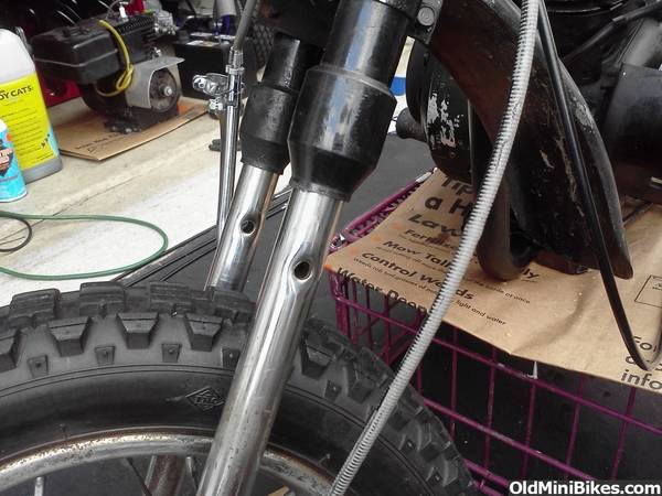

pretty sure you need to take off the rubber seals on the upper tubes .put the pins through the lowers and the spring loops then slide the seals below the pins insert the assembly into the uppers and put the top bolts back in and slide the seals back in place.

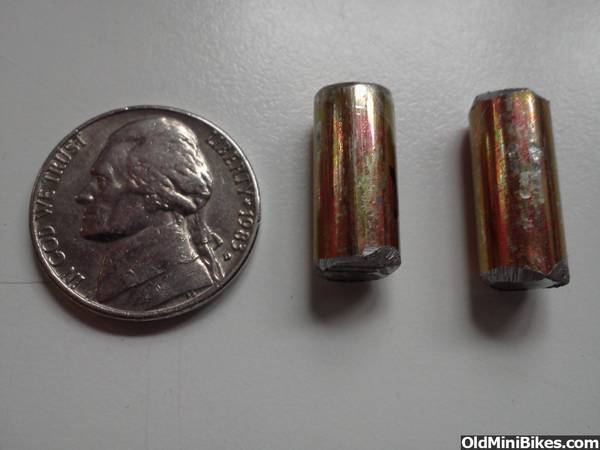

good thing they didn't fall out when you were ridin wheelies :laugh:
