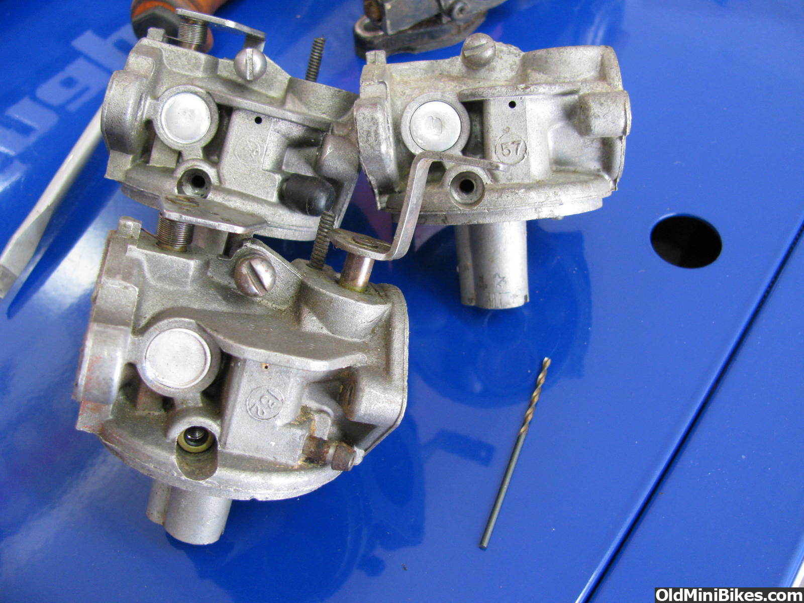

Heres what I do with the primer carbs when I convert:
Heres the bowl type (top left I drilled out the small vent hole to the larger size so I could cap the primer inlet off, bottom left is undrilled, right is normal non primer with the larger vent)
If its not overflowing from the bowl and more like puking fuel out/spitting back when trying to run, then you need to look at timing or ignition issue but I would drop the bowl first and see whats in there and go from there.

I just removed the primer tube and left it uncapped on the carb. Thanks for the pictures. Should I cap that and drill out that vent hole?

We capped the vent & drilled out the hole. The small vent that was there was partially blocked.
