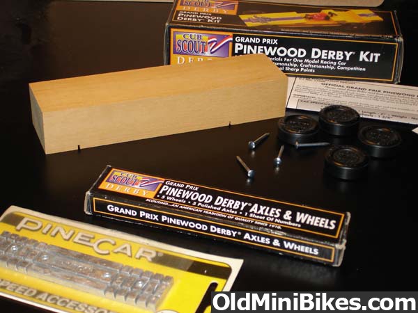

I remember building these with my twin boys quite a few years ago (and for a couple of years). Those were very fun to build. Well those cars are long gone since the boys are now 26 years old, but I can remember being more fired up to build them than they were. Finished 1st and second place 2 years in a row and went on to the finals which we didn't fare so well.
I remember:
filling the wheel holes with epoxy and machining the holes
using graphite on the axles
making sure there wasn't any flashing on those axles and polishing them.
adding weight to the underside in machined pockets (not to hang below the bottom) held in place with glue.
We also made fenders out of 1/4" wood and glued them to the sides of the body to look more like a car you would find on the street.

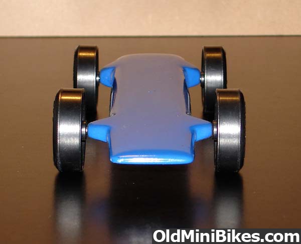

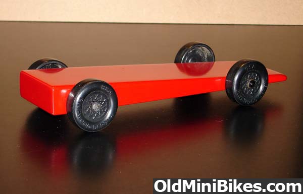

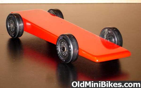

Thankfully, my son saved our cars from his mom's place and brought them over to my house in a box. Luckily, his mom didn't destroy them or throw them out. They were all made many years ago and are a little dirty from being stored but, I've got them on display on a shelf in my spare bedroom. I cherish the time I spent with my son building and racing the pinewood derby and these cars are a reminder of that time.

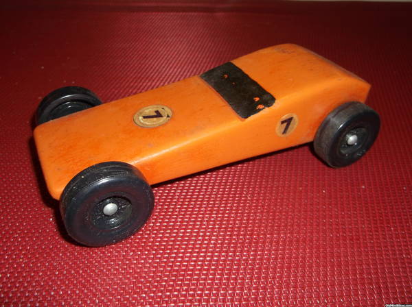

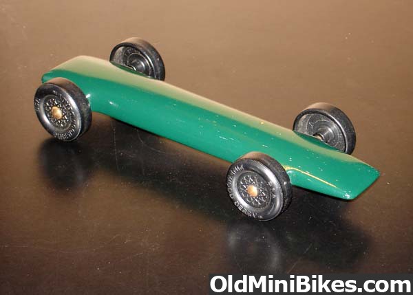

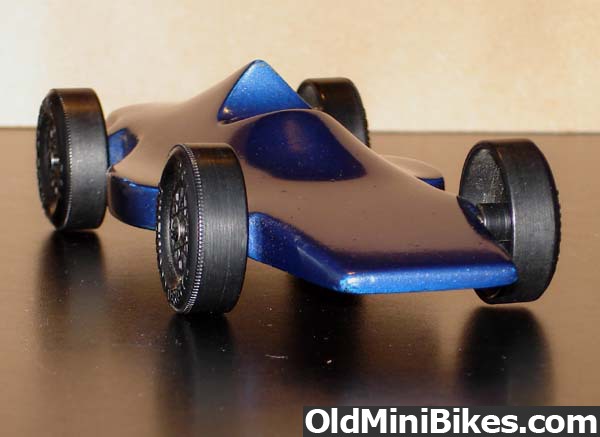

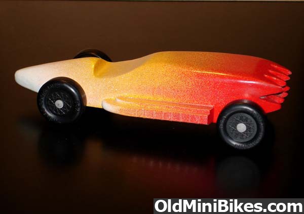

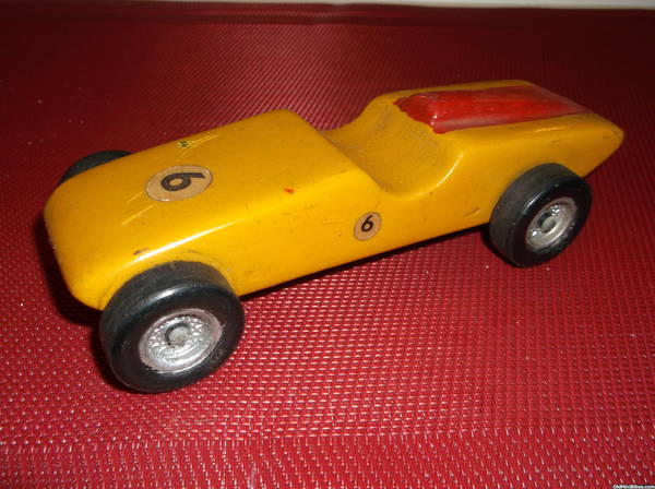

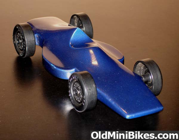

I don't have my old pictures to show for now so, I've taken some new pics of our cars to share with everyone here.

Found them.
First one I built when my older brother was in Cub Scouts. I couldn't compete so it wasn't weighed in.
Next year, my first year in Cub Scouts. My brother took first and I took third. It was a photo finish and even in the Newspaper photo you could see I took second. (I'm still pissed about it to this day. LOL)
Next year. My brother took third and I took first.
My last year in Cub Scouts. It didn't place. I blame the fact that I forgot to sand the front wheels.
Four cars that never raced.
