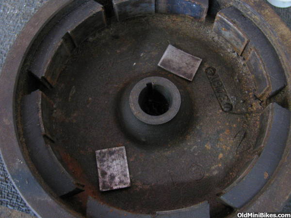

It is an HS50 the easy "tell" is the intake. The engine is 1973-74 version due to the way the block is configured (which does mesh with the scat cat pretty good). those used the Later 70's thicker/heavier flywheels, HS50 actually had an aluminum version for the first 2 years but it got superseded to the steel flywheel with plastic fins just like the HS40 got when it changed to square shroud in 1974/75. Far as locating a lighted flywheel for that era....Its tough to do. And the spacers that are glued to the magnets on the steel 1974-1980 flywheels commonly come loose so you have to watch that they are all there if buying used, and a good idea make sure they are secured (re glue if necessary) before being put back into service.
Here is an example and why that 1975 Rupp I bought long time back had an engine that was "locked up"....wasn't the engine it was the loose spacers causing a bind.
It is important to note that you cannot use a lighted stator plate/magneto with a non lighted flywheel and vice versa. they are physically different sizes so they cannot be mixed as it will bind or will have way too much airgap and not fire the plug depending on which way you go/try. So in your senario you will need a lighted flywheel or change the stator out to a standard unit and standard flywheel if you can live without lights.
