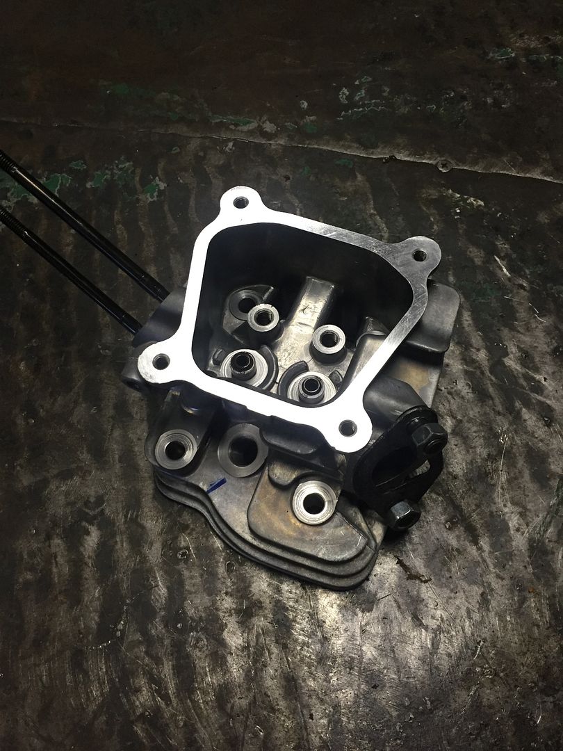

Which predator do you have , if you have the 69730 then you have one of the best head made . Look on your head and see if it's say RTC 6 or RTC 8 . If you have either then keep them have it milled and run it . The 18cc clone head is not all that , ports are not that great . If you have either head I listed then you have a big valve big port head and it's one of the best clone heads out there . Far better than the OldMiniBikes head .
I built a hemi predator and went out and bought a complete new 69730 just to get that head .
