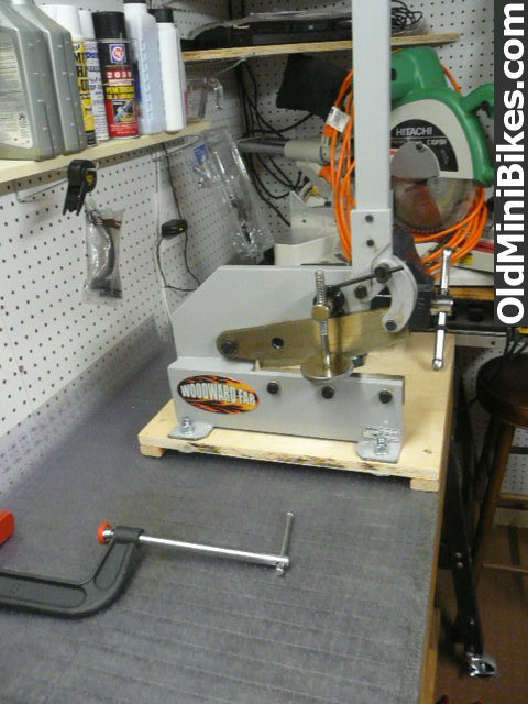

Here is one of my favorite new tools that I bought, along with the mounting plate I bolted it to so that I don't have to drill holes all over my bench.
This is the Woodward Fab 8" Throatless shear, which has a capability, according to the manufacturer, of cutting 3/16" thk steel plate, or 1/4" thk aluminum plate, or cutting 3/8" steel rod. I paid $119 for it with free shipping to my door direct from the manufacturer:

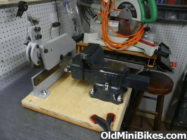

I mounted the shear and a vice together on an 18"x18"x3/4" plywood board which has a 2x4 on one edge as shown below. I can rotate the vice and mount the board to the bench with c-clamps. Here, the shear is mounted in the ready to use position on the right corner of the bench...

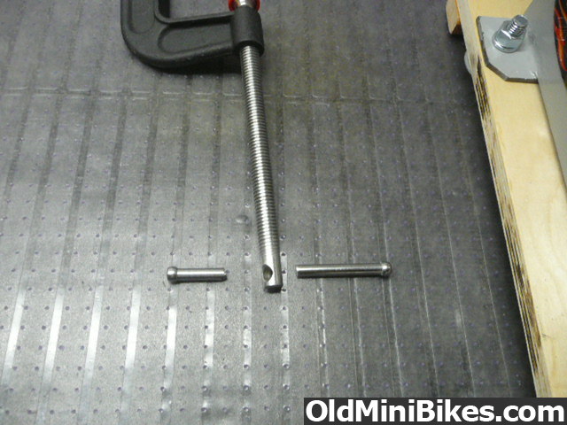

Here's the first project I used the shear on... As an aside, I do not like the way c-clamps use a cross-sliding rod as the rod is slow to use and the rod always seems to be in the way. I usually remove the rod altogether using a hacksaw. Now when I use c-clamps I can quickly hand tighten or open the c-clamps most of the way, only using a Phillips screw driver through the hole at the last 1/2 turn... Instead of a hacksaw, I used the shear to remove the 1/4" dia. rod, no sweat, no shavings...

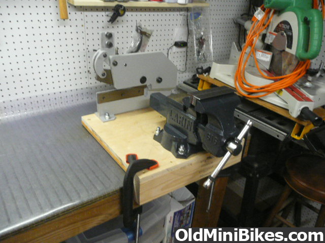

If I want to use the vice, I c-clamp the mounting board anywhere along the front of the benchtop with the 2x4 in front, like so...

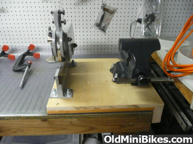

Or I can rotate the vice on it's base to use the vice's anvil...
