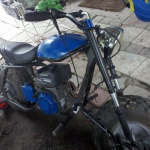

So a few years back we acquired a Firehawk, It was in rough shape and needed a new life. Skip forward 4 years and a bunch of planning back and forth finally i decided to start it and give my self a deadline of before memorial day so we have a 3rd bike for people to ride at our cookout. This...

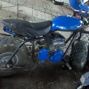

Hello I'm new to the forum and found this place searching for info on my bike. I have a tomberlin firehawk with a Mitsubishi gt600 motor. So far I've added a comet tav2 30 which took quite a bit of modification. The bikes now doing right at 40 mph top speed. The problem I'm having is finding...

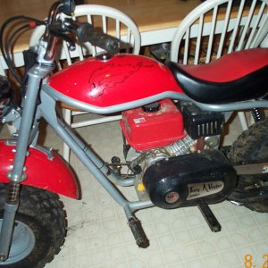

Anybody familiar with a Firehawk? It is related to a Warrior. The frame is the same everywhere except that the back bone is split and the seat mount is different. I bought a roller less engine, fenders and seat. I took pics but my camera wont work with Windows 10..... Always something else to...

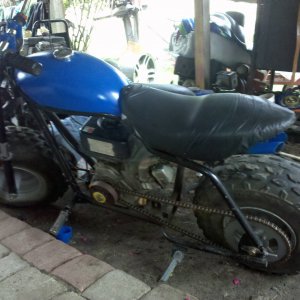

I have a 5 hp briggs that has a 20 mm slide carb on it that I am running on my firehawk with a tav2. I also have the 6 hp Mitsubishi ohv that came with the firehawk which is the same a the 6 hp vanguard but have been waiting for parts (new pushrods , and rocker adjusters) that are being special...
