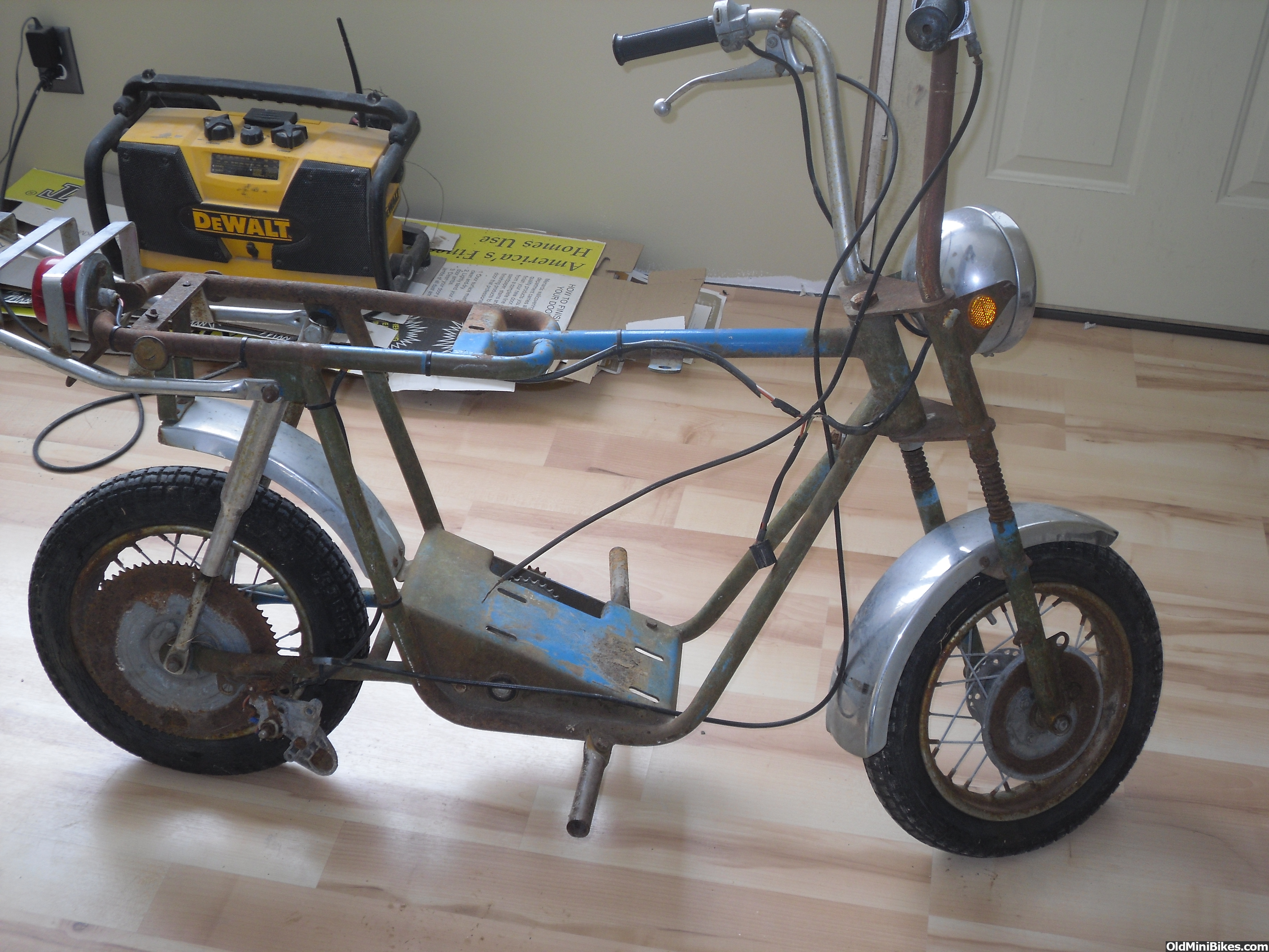

This started with a purchase off of the local Craigslist. I thought it looked cool and needed to be saved. I now have gotten 2 more rollers and another frame and fork set, all in my efforts to reach my goal. Has this gotten out of control? :shrug:
A picture of the original purchase

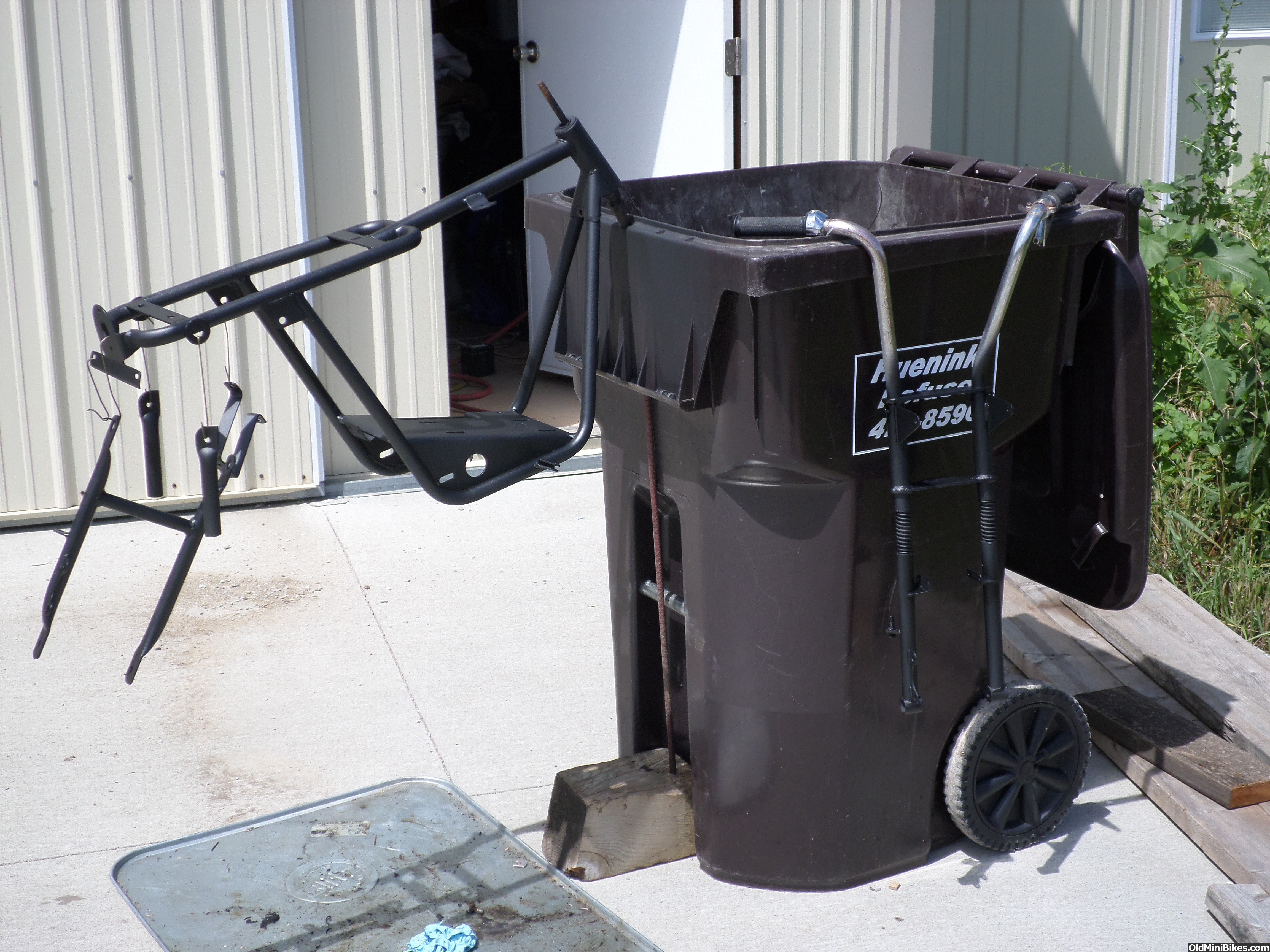

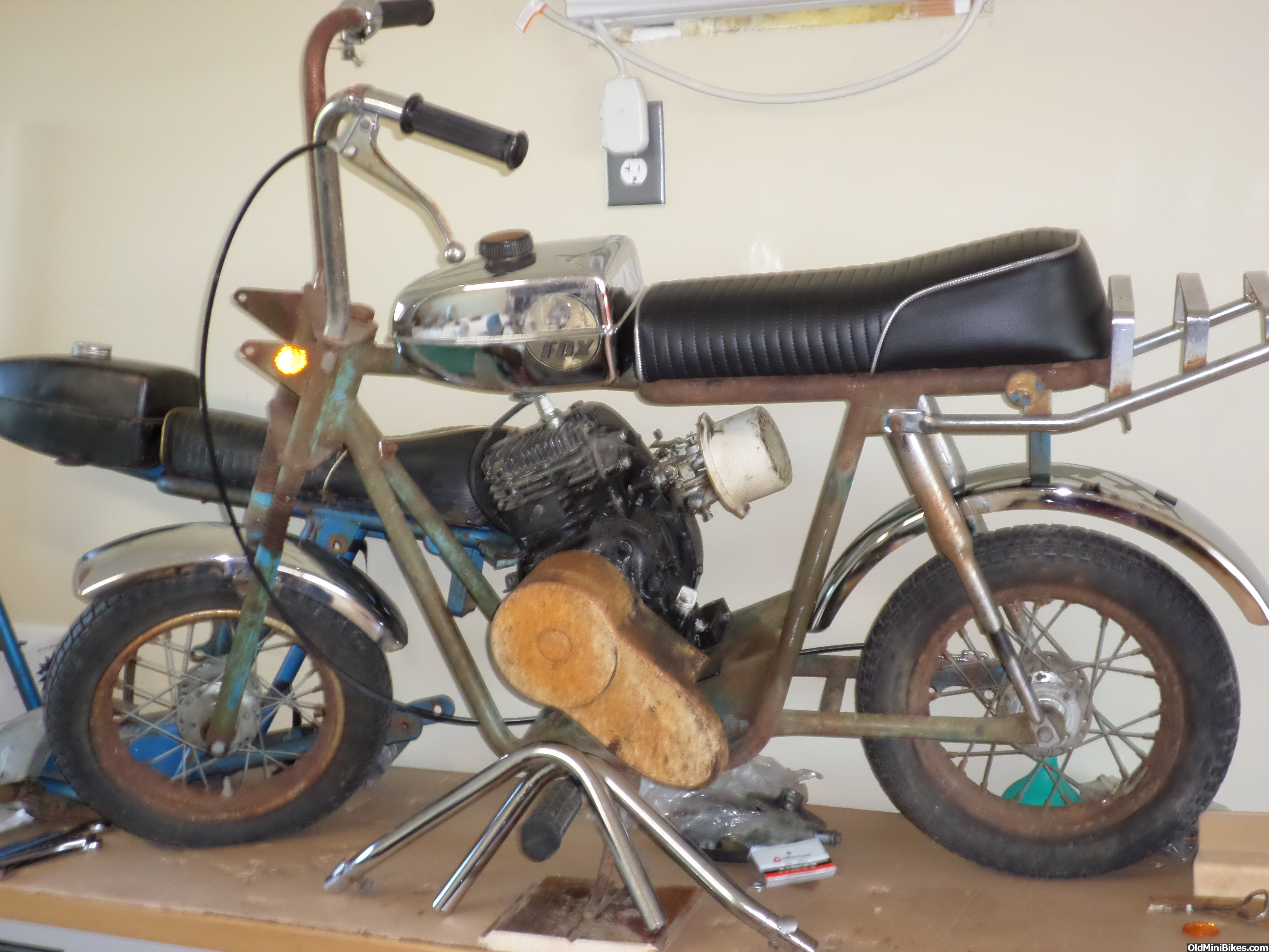

And a few of the upgrades
Next thing is to blast the frame and add a fresh coat of paint.

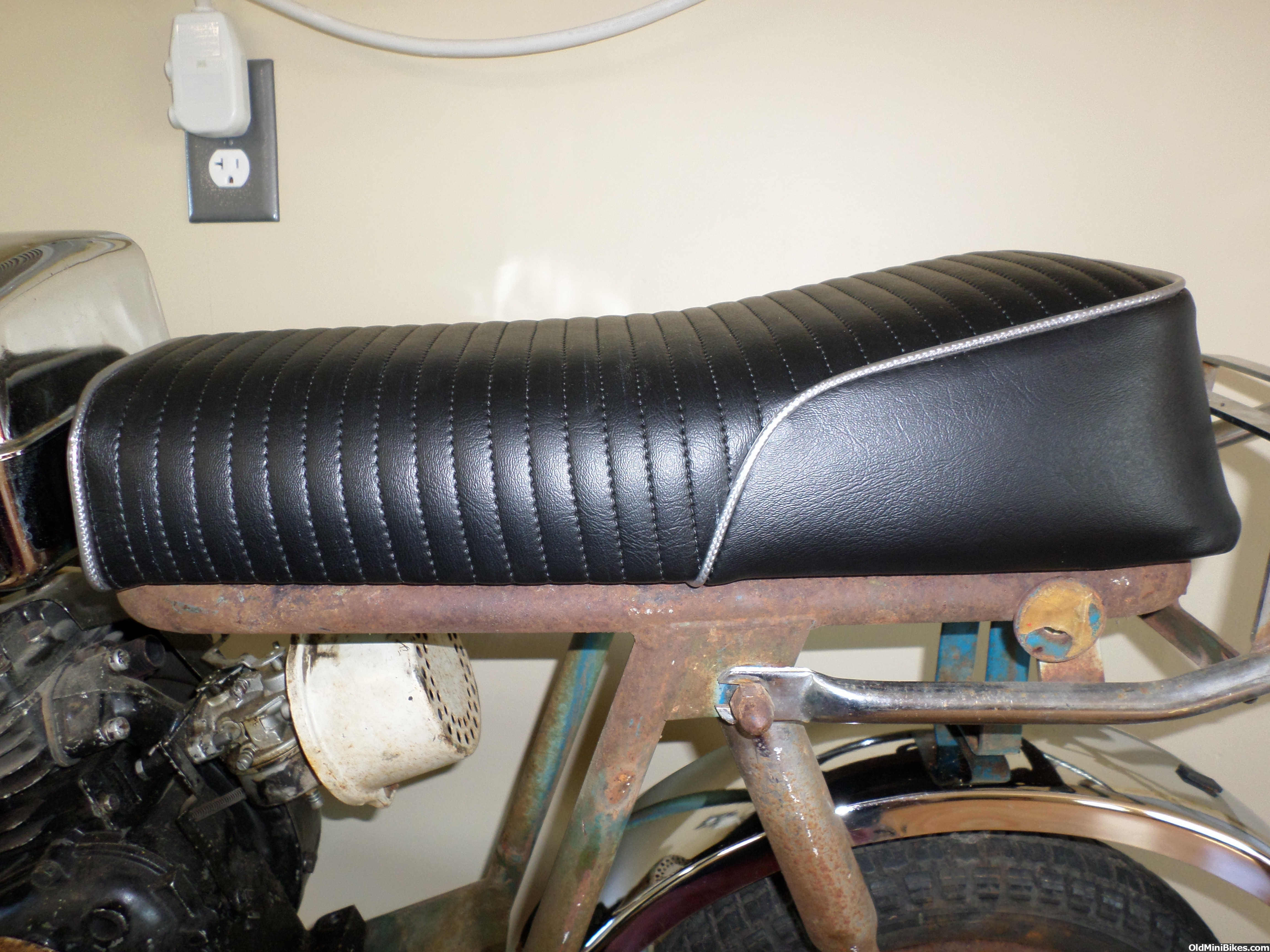

It is something special. Hope I can keep you entertained buckeye. I understand you and Ogy are the Fox guys.
Thanks John G. Now that I have a good pattern made others will be better. And it is easier then upholstering airplanes. :laugh:

Hey Loren looking like a great start. Loren are you going to paint it yourself? Have you found everything you need? Have fun and great job on the seat. :scooter:

Kind of getting excited now, yes, I will paint it myself and thanks for the compliment on the seat. It's a lot easier then the stuff I do at work.

Well.... I haven't been able to keep at this project, but I finally got things blasted and today got the frame parts primed in epoxy.
Need to pick up some filler and start the finish work.

Oh and how did you get a seat pattern?
If I may ask?

I needed the longer PTO shaft to work with the 2 speed clutch. Still haven't found one. Thinking that I may just weld a piece to the end of the existing shaft.
