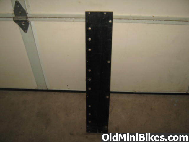

I have this big sheet of Bakelite.
I was cutting it just a few moments ago when that uneasy feeling hit me...
This is awful nice cutting and no fluff....
No woody smell from the filler.
No glass or canvas.
Then the sun glinted off something as I held the piece in my hand.
I took out my Eyeloop for a closer look and I could see some fine fibers in it.
Now without actual testing you never will know but this part you see here was carved from a 1 inch thick board of high quality electrical grade black Phenolic.
And Probably 10% asbestos filler.
SO I just thought I would pass it along as tip.
If its free and scrap and old as the hills...
If its too good to be true....
You might want to think twice before you bring it home and turn it to dust.
I just spent the past hour washing my workshop with the garden hose.

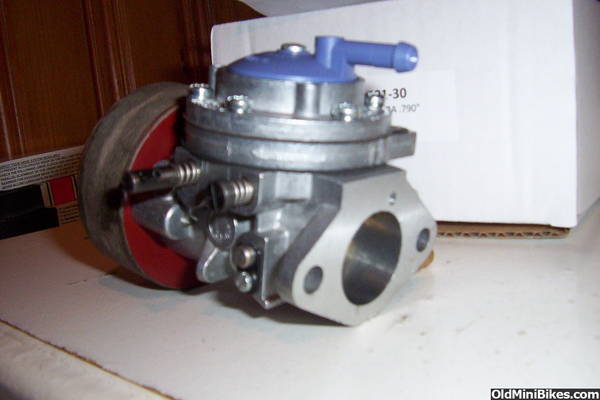

Here's a nice air filter adaptor I made from it last summer.
Notice now in hindsight you can see there is some sort of filler in it.
I just never gave it any thought untll now.
