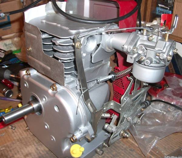

A 8hp Tecumseh carb along with a 3-3.5hp Tecumseh manifold work great on a Briggs 5hp FH, both stock and modified. I also have a Tillotson (not sure the model) and manifold on another that also works very well. Personally, I would go with a Tilllotson over a Mikuni because of the adjustability with changing jets.

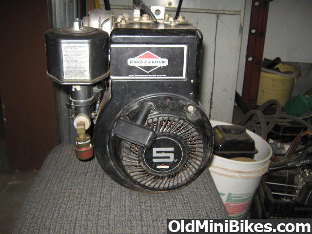

Here is the engine i found...
Never used at an estate sale
its always sad looking through a dead persons stuff.
makes me wonder....
