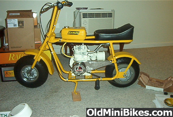

I'm building a Banchi with my son and we have the rear turbine wheel with the drum....but that's it. Is the some where we can get the rest of the brake system? Do they make a aftermarket part that will work with that drum wheel combination? I'd like to keep that as the brake system but I guess I could go with a clutch brake.

Shame on me but I ordered the 5" Bendix brake and didn't measure the drum I have......well of course my drum is too small. I measure it and come up with just over 4 1/4. Any ideas? Thanks again for the help. Sorting this brake out is turning me gray!:hammer:

Well I ordered the 4 1/4 from OldMiniBikes and it does not work with the wheel or the drum I have.The drum I have has an ID of 4.325 and mounts with six bolts on the inside of the drum. I didn't want to alter the frame for a scrubber brake and I didn't want a clutch brake but I think I'm heading in one of these directions.:confused::eek:

After many phone calls and measurements, what I have is very different from what I can buy. Ended up going with the clutch brake. Vicky was very patient and nice in dealing with me and my strange/unique situation. Thank you Vicky.
