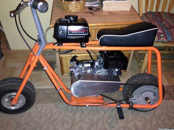

I picked this Asuza frame up at a yardsale last week. It looked like it might make a fun project for my son and I to tinker with and at $40 I couldn't pass it up. So far We've modified the handlebars a little and ordered a 6.5hp engine from Harbor Freight. I also ordered a heavy duty clutch, chain, and a few other little items from OldMiniBikes warehouse. I'm planing on Fabricating some fenders for it, and slapping on a coat of paint over the next few days.
I'll post more pics as the project progresses.

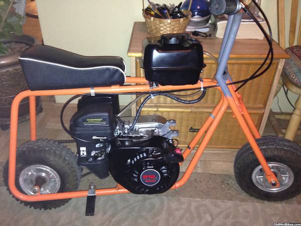

My Predator 212 finally arrived today, as did my clutch and chain kit from OldMiniBikes Warehouse. I am a little disappointed because the chain is to short. I figured that 4 ft would be plenty long but it is 2 inches shy of making it all the way around. I ordered a longer chain as well as a spacer kit for the clutch.
The engine bolted right up to the mounting plate on my Azusa but I'm going to have to relocate the fuel tank. It fits in the frame but there's not enough room to get the gas cap on and off. I plan on welding on some fender mounts and relocating the tank this weekend.

It was an absolutely beautiful day here in NW Florida and my son and I spent the better part of the afternoon out in the driveway working on the mini. We got the gas tank relocated, hooked up the throttle, installed the clutch and chain, and even got started on the fender support brackets before it got dark. With any luck we should be able to take her out for a test run in the morning. Once we get her running right we plan on tearing it back down and painting.
Just a little advise, I had one of those as well. That bike has some serious torque off the line with that rear sprocket. . Not an issue for me too much weight but my eight year old flipped it right out from under himself, twice. Nice little bike especially for $40. Good luck and looking forward to seeing your work.
I fired the Mini up this morning for the first time. She started on the 2nd pull and runs like a scalded dog. HOLY COW you guys were right, this thing is fast and has loads of torque. I'm gonna have to buy a smaller engine or just build another bike for the boy. He can have this one for when he's a bit older.
Ive got the same motor and gearing on one of mine too, its a handful out of the hole! Mine is also tight on the gas cap to frame room but it makes it in and out...barely.

Great find for the price and I like the mods you've done...got a color in mind yet?

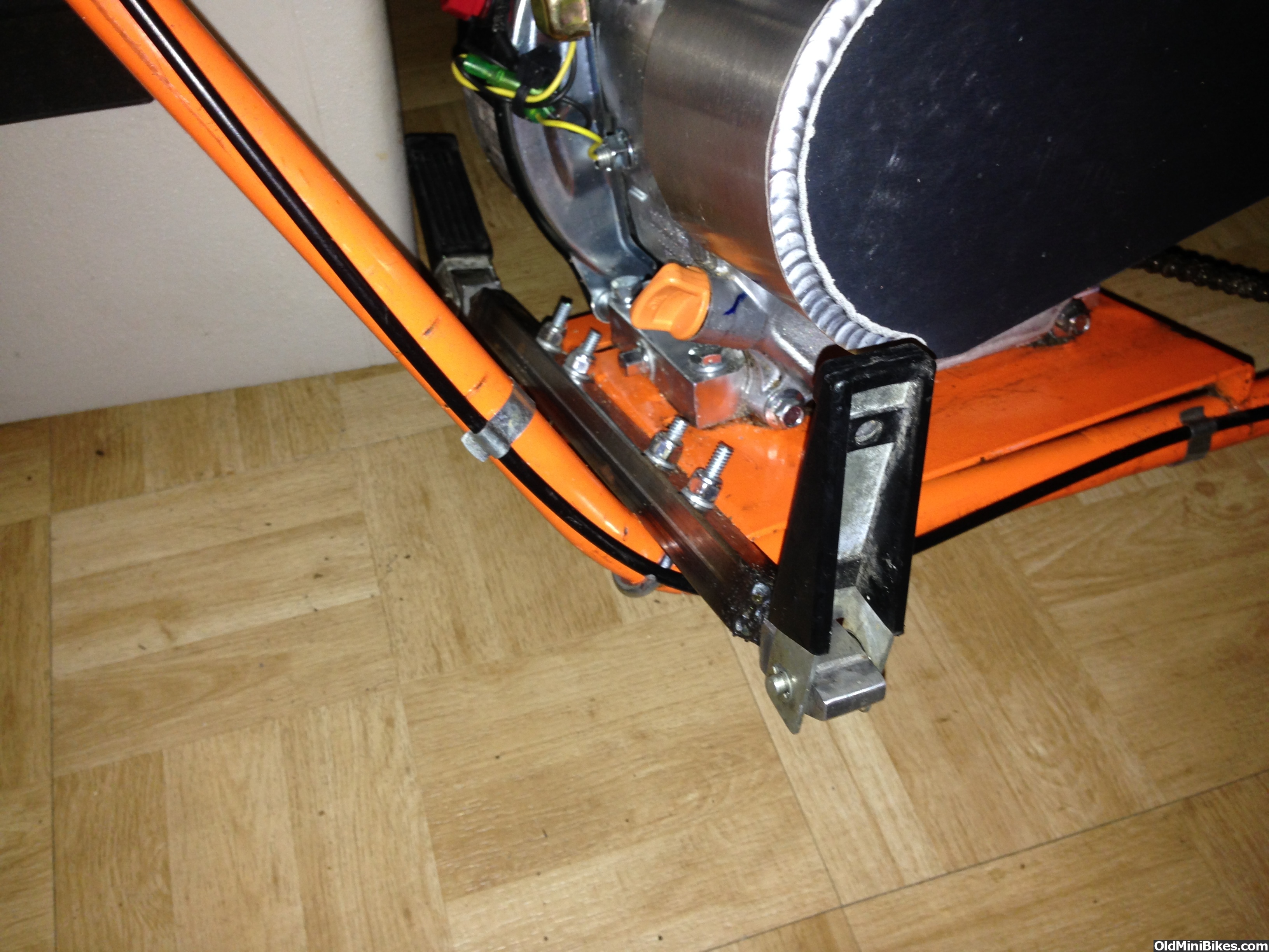

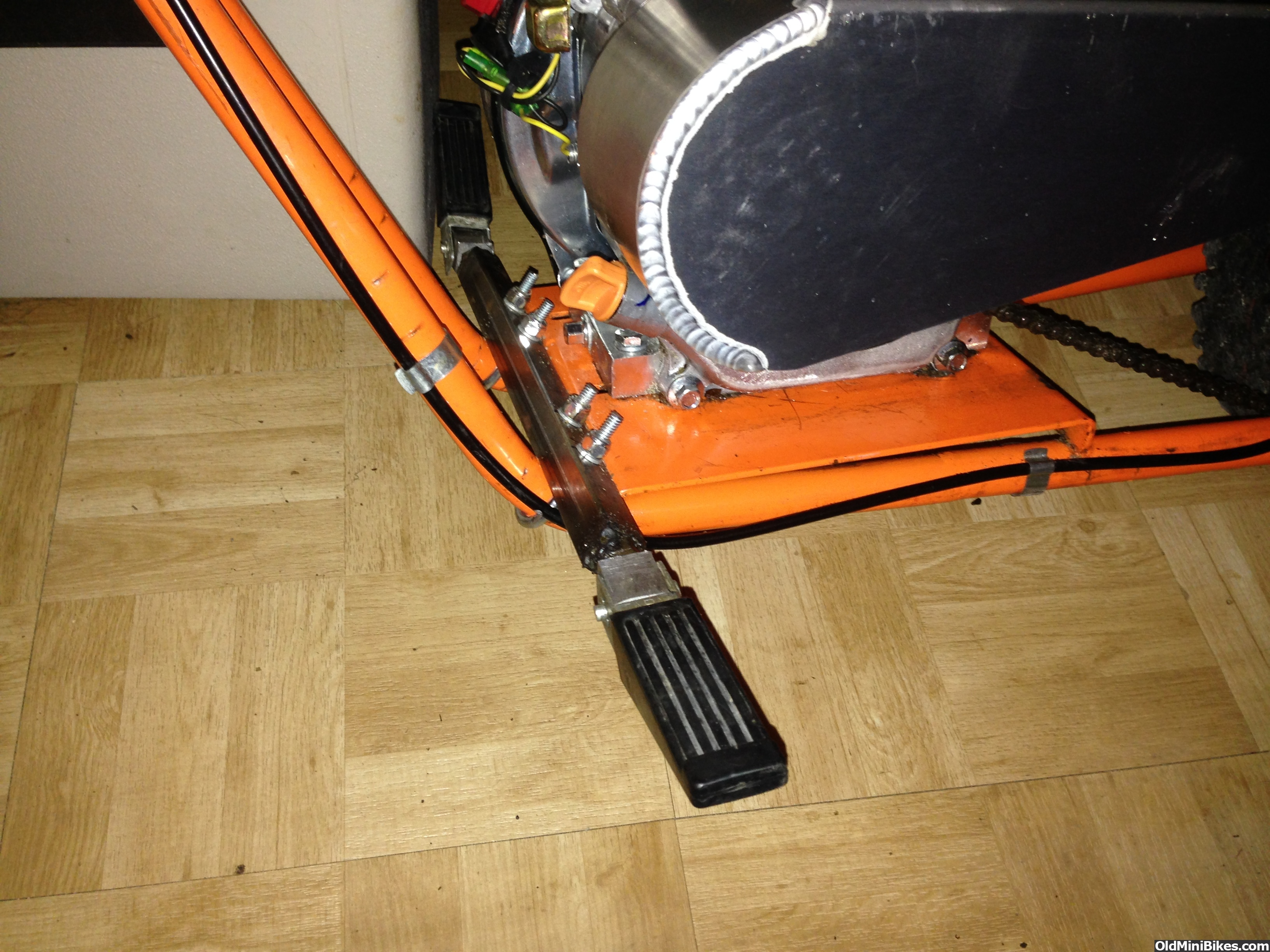

I just finished fabricating and mounting the foot pegs. I took some 3/4 bar stock, welded the nuts from some old folding footpegs I had laying around and voila. The bike feels allot more stable now that I have some good solid pegs. Before I built these I had to mount the pegs behind the engine mounting plate because the engine was to wide for the clamp on pegs to work up front. I decided to use the ubolts instead of welding so that I can move them around if I need to, also my welds can get a little ugly sometimes. I also installed a 60 tooth sprocket which has tamed this beast down considerably. Can't wait to get her out on some pavement. So far I've just been riding it around the yard.
