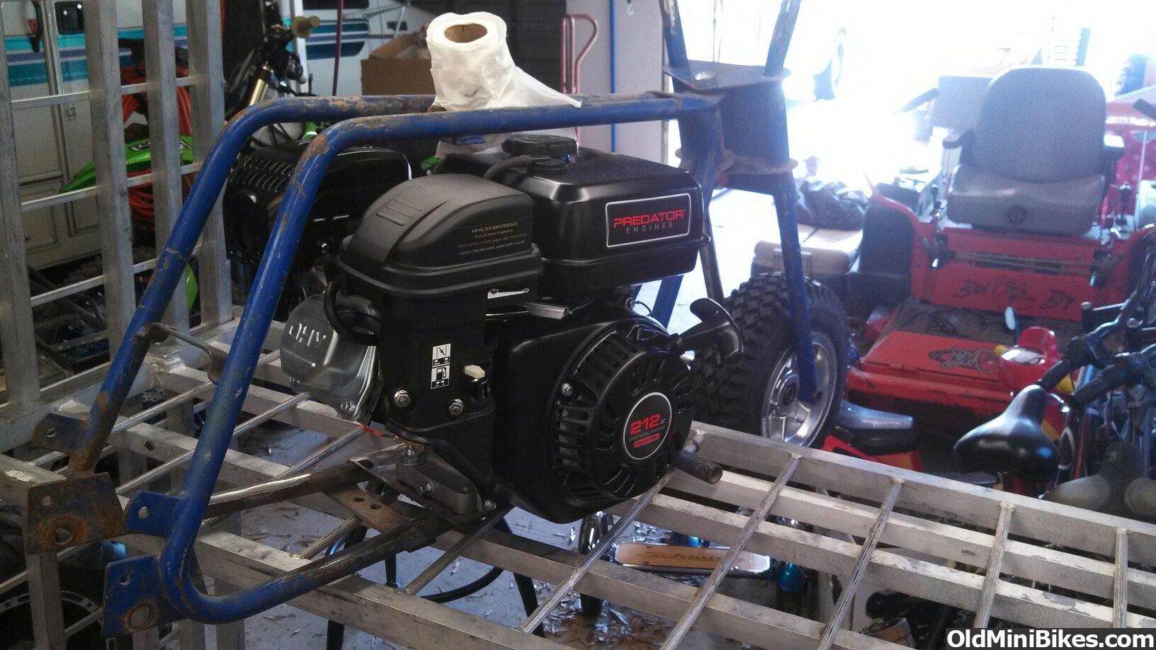

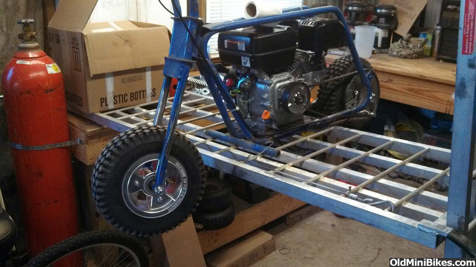

After looking through the tool forum (which is really cool ) I've seen a number of ideas for mini bike stands . Well this is what I came up with for working on my build-off , most guys have ATV ramps , set one side on your work-bench and other side vertical to the ground , they will lock together and become very stable and are open from bottom side to easily tighten engine bolts and etc, ! Also it puts the bike at a comfortable working height too ! Only draw back , you gotta pick up the bike to get it up there !
