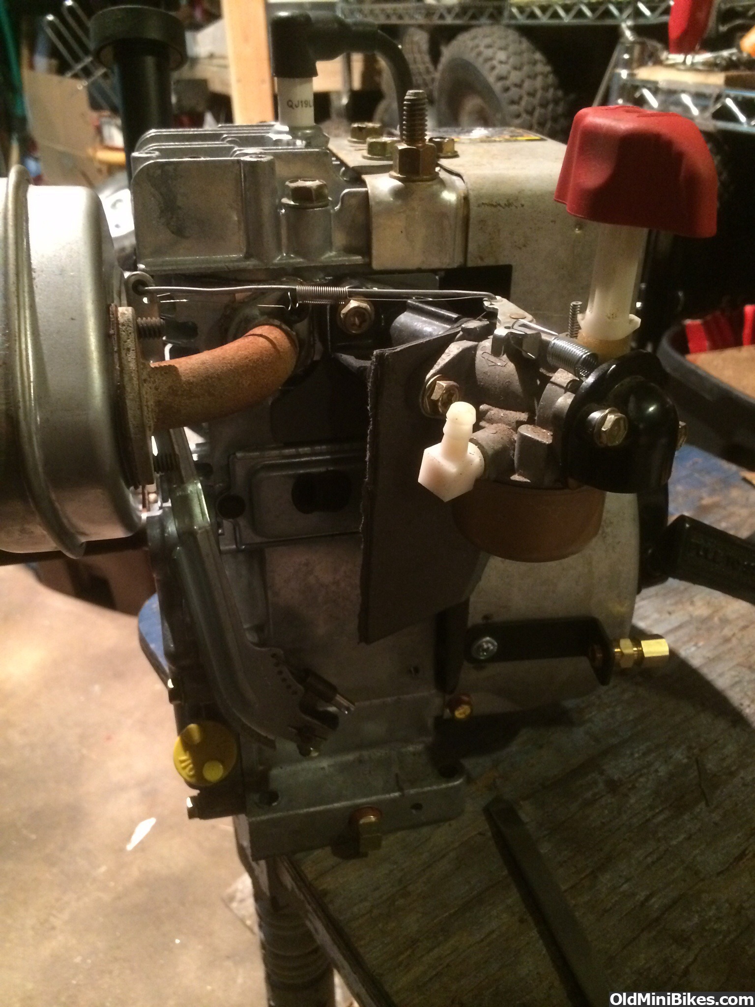

I'm wondering if the Tecumseh throttle setup from OldMiniBikes could be used in this situation. The governor would probably still work as well.
#7
Well I gave it a shot. I had a throttle linkage kit for a clone laying around. I mounted the piece that hold cable to the shroud and moved the spring to the top of the carb. Looks like it should work.
