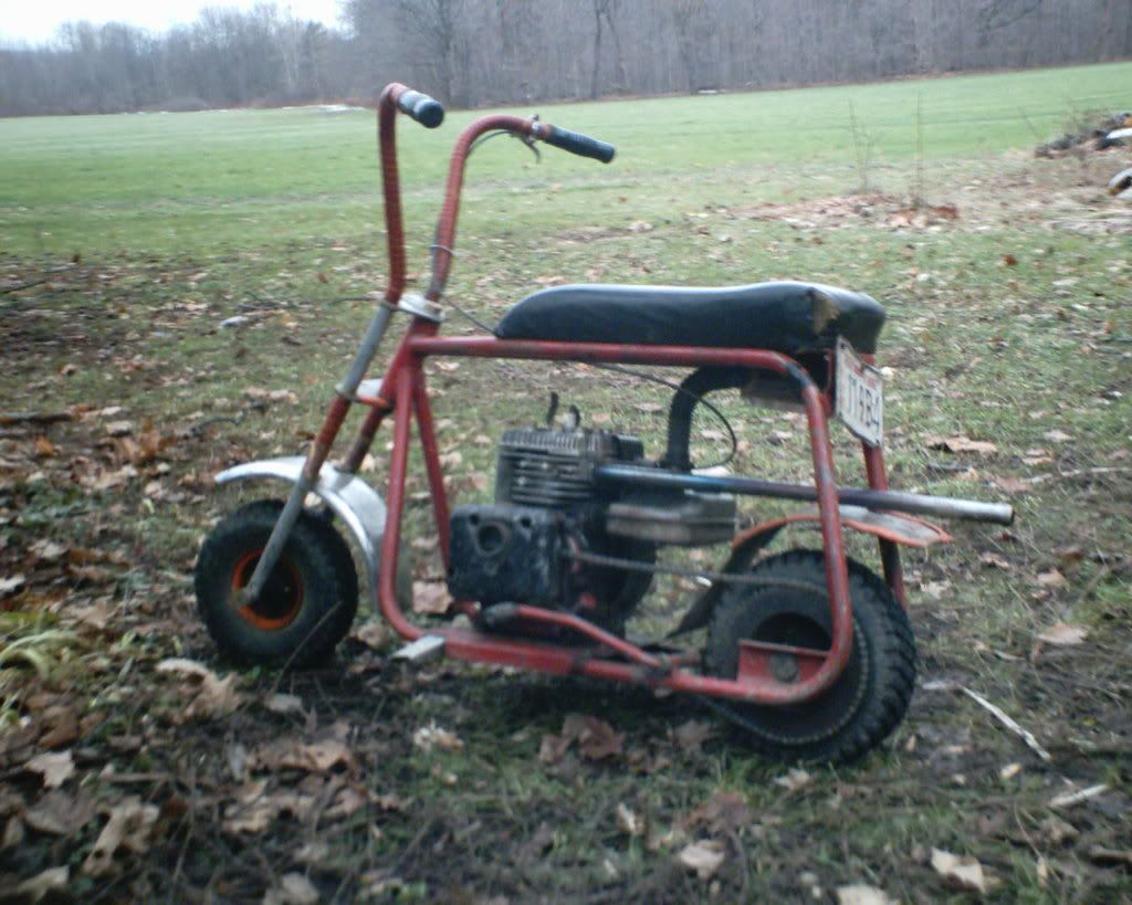

well, finally i got my pics and videos of my minibike uploaded to photobucket, so here is a pic and vid of my Fox Sprite. (sorry i don't have a vid of me riding it, but i will get a vid tomorrow)
the engine is a B&S 2.5HP flathead that i ported and polished the intake, drilled the main jet, very slightly shaved the head, stiffend the valve springs, and bypassed the governor.
