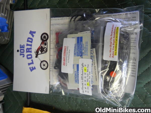

Red LED Light kit with some freebies. Joe Florida koozie and stickers!

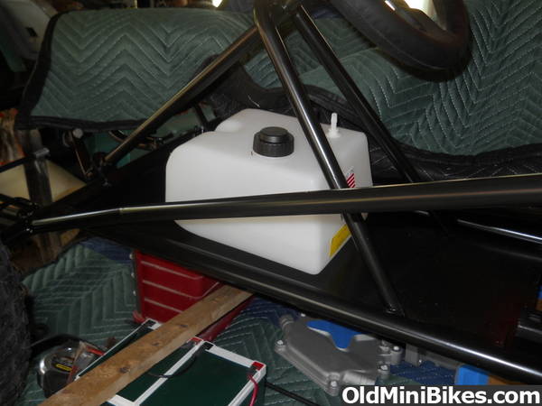

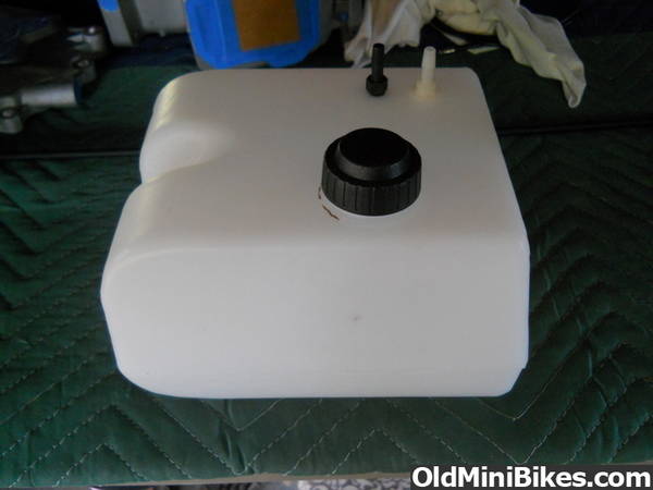

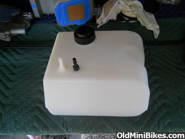

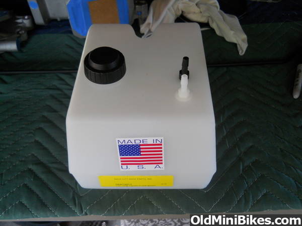

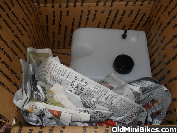

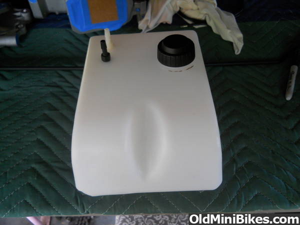

Was going to build a custom fuel tank over the axle next to the engine. But, I have found another use for that space. Then I ran across this tank that I think fits nicely up front.

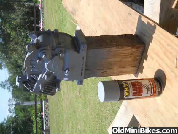

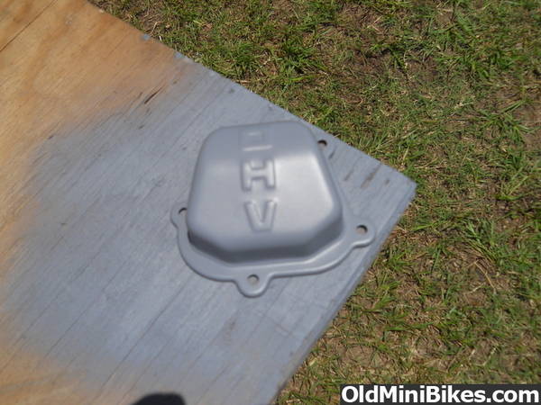

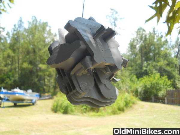

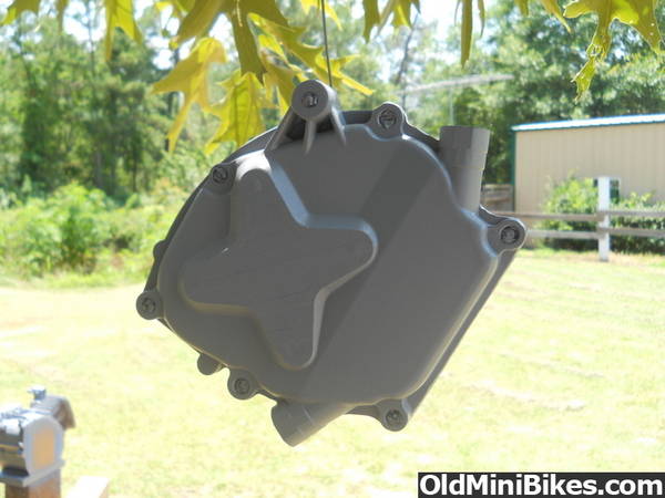

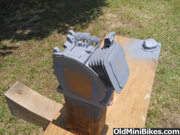

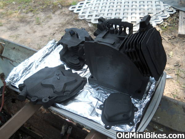

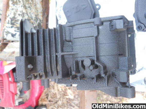

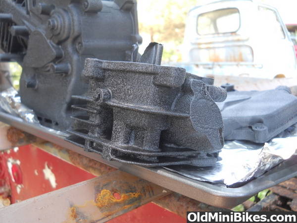

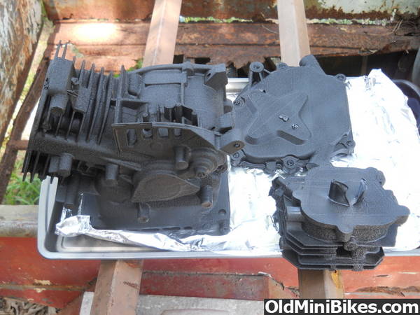

I let the primer dry for 24hrs and then applied the wrinkle coat. Hot day and the paint started to wrinkle before I even got all the parts coated. I had the oven preheated to 200 degrees and baked them for one hour immediatly after. I left all of the masking on but coated everything with the wrinkle.
There where three bubbles on the side cover, two where on the masking and the other was from a casting mark on the casing. Scraped the bubble off and it was still coated with the wrinkle underneath.
Head looks really nice.
and block came out really nice too.
Valve cover coat was a little thin on the exhaust side, I think I can add a coat but I'm not going to worry about it.

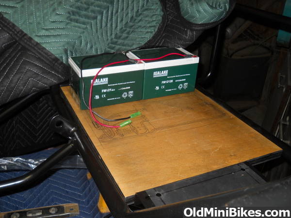

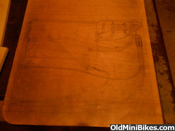

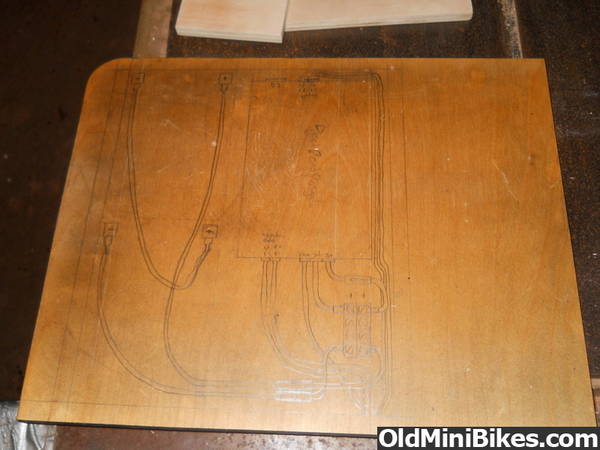

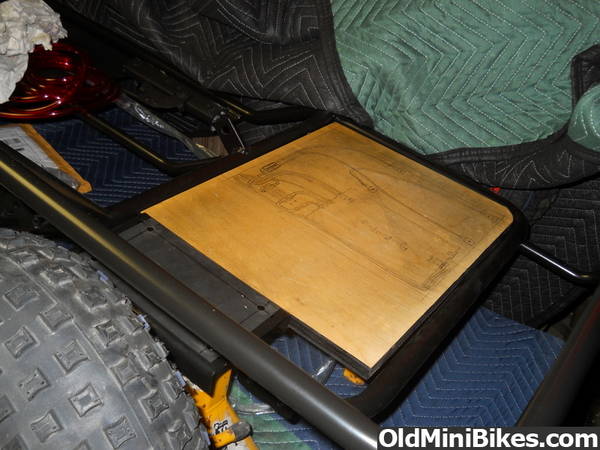

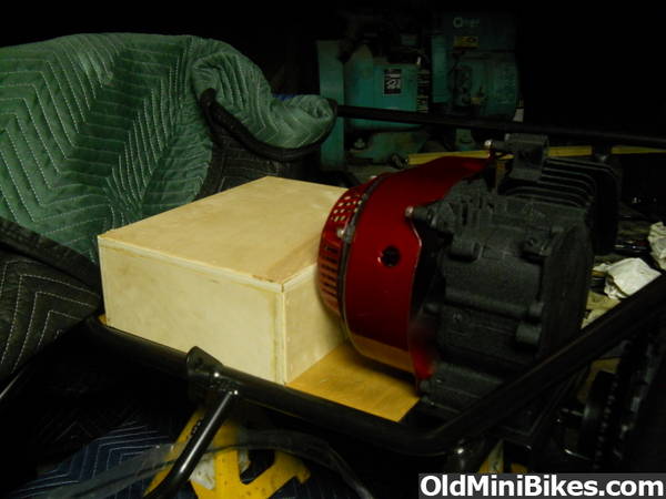

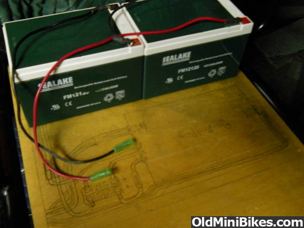

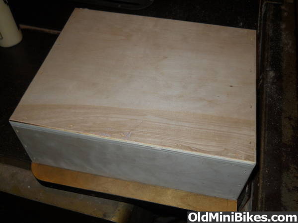

Starting to mock up the electrical system.
Had these batteries from an old e-scooter that I could not get to work, but the batteries are still good.
Still not sure if I like the box, may slant it down over the amp for more airflow to the flywheel.

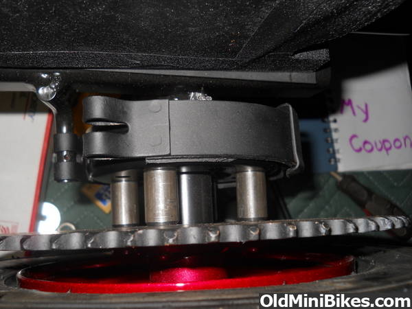

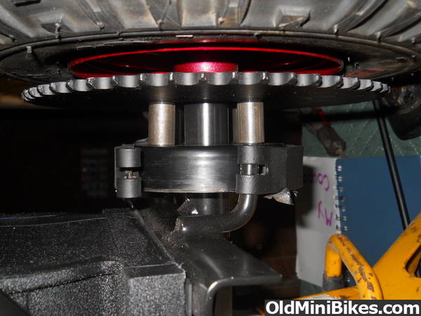

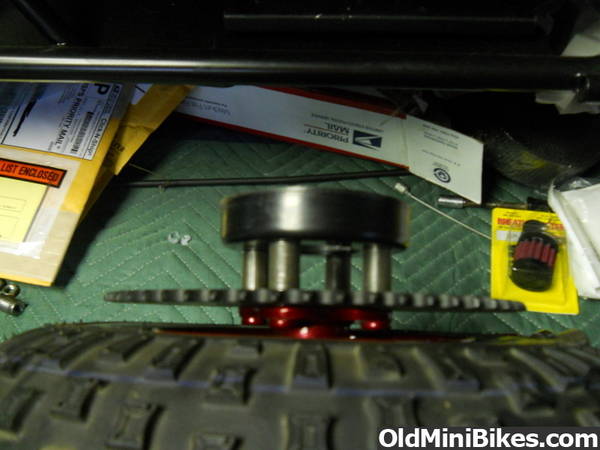

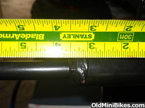

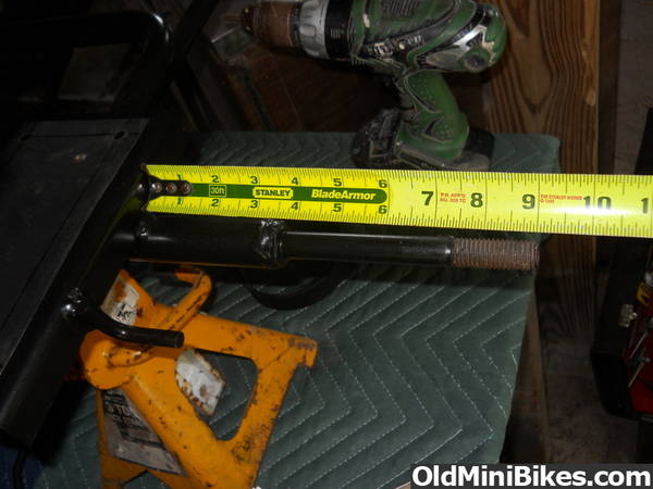

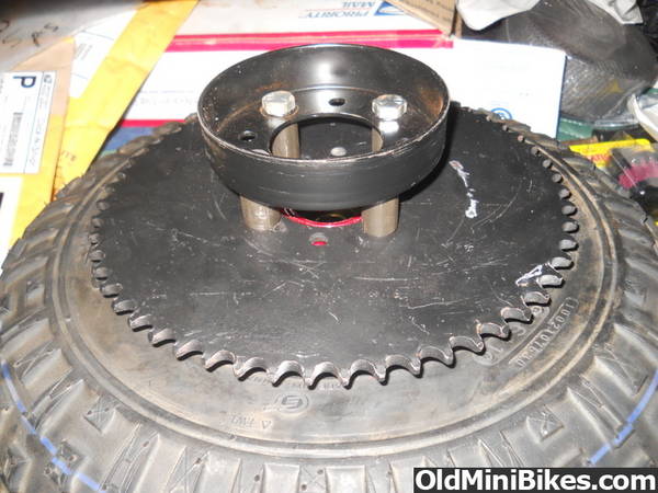

Where you are at 3 1/2" and mine is 5". Definitely different. I wonder what rims/spacers mine had originally.
I see what you are saying, makes it kinda hard to space the brake band out that far. I would see about having someone machine a solid single spacer that you could bolt to the sprocket and rim and then another set of holes tapped for the brake band. No idea what that would cost. I found a site that had a cross reference chart with serial numbers, model name.

looks like it originally had three 5/16-18x4 and three 5/16-18x3 with three 3/8 nuts stacked as spacers between the drum and sprocket and the sprocket and wheel spacer.

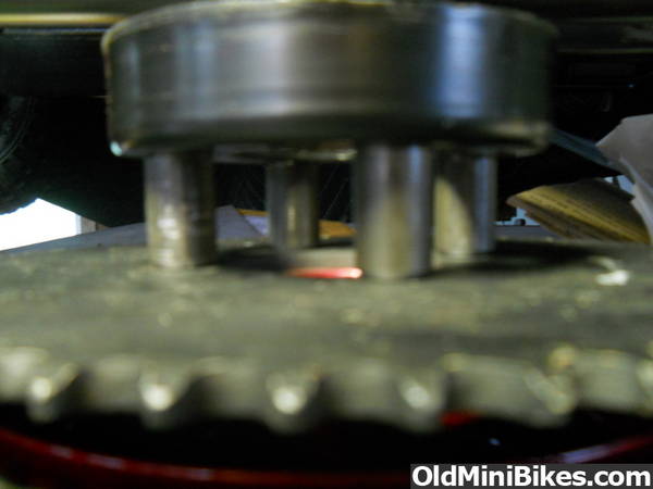

Here's what I ended up doing.
http://i.imgur.com/HhCeQ.jpg
It seems to work fine. There is a very slight wobble on the sprocket but it's not due to the spacers. The sprocket is slightly warped. No problems from it so far.
The engine is very strong. It spins the tire easily and then just stops accelerating at ~19 mph. It's perfect.

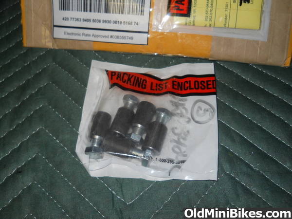

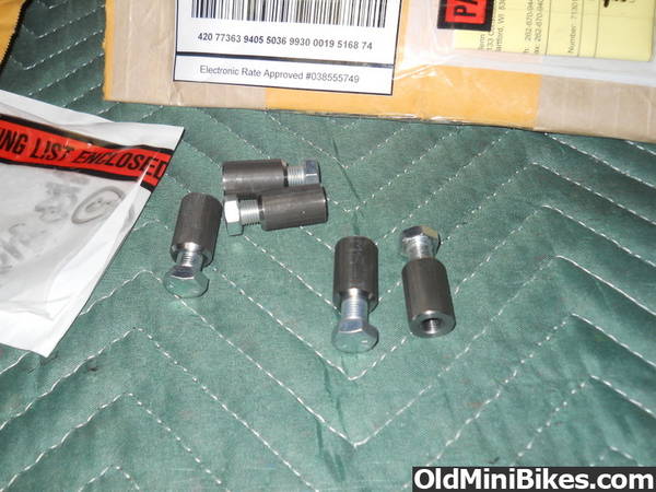

Got a couple of packages. One from Hefner Racing and one from AGK. Haven't done much on the kart this week. Going to try and order engine parts from AGK this week, connecting rod, flat top piston, and billet flywheel. Still trying to find an upholsterer.

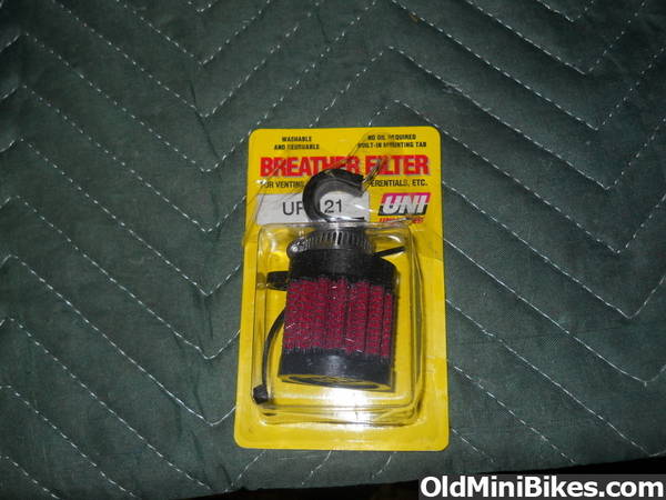

Breather filter finally came, ordered one month ago. Still waiting on indexing washers.
One inch bosses from Hefner Racing to space the brake drum.
