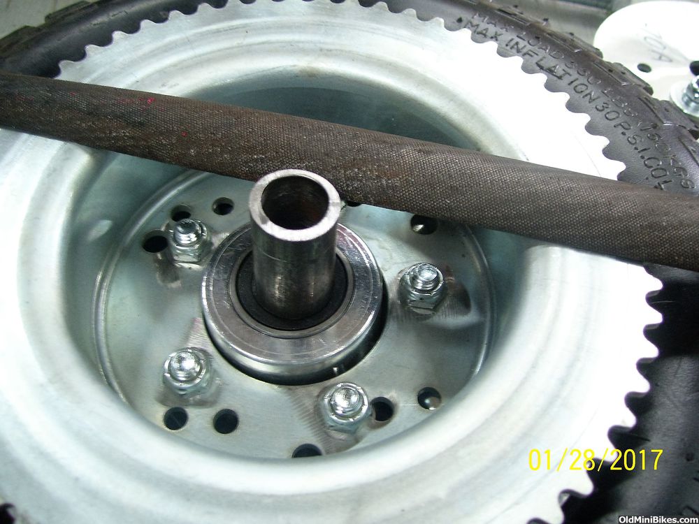

I emailed Azusa about my drum brake frustration and received a speedy answer. The ol' brake dragging against the drum was my concern with my tri-star wheel with the drum brake kit. Seemed like the brake was hitting the bolt heads when rotated in either direction; hence the 1/3 travel within the drum (3 bolts).
Azusa resonded with, "You will need a spacer (1-1/4" long) between the backing plate and the wheel bearing to keep the brake from sliding into the drum."
Has everyone tried this? If I have a 1-1/4" spacer I will give this a try.

what Azusa rims and sprockets wobble?....i feel your pain......I tack weld a 5/8"x1" spacer to the back of the brake drum center it with a short 5/8" bolt.....toss the sprocket and use a precision tri star sprocket from the Taco mini bike guy save a ton of frustration this gets you close.....if this fails put the rim together with the sprocket and have a machinist put it on a lathe and true it.....The Azusa levers are junk go to your local motorcycle supply or check out emco.com part#428-62406 7/8" short lever or flanders motorcycle supply good for 1" stuff also.and Quality throttles also...get a good barnett cable that fits the lever
