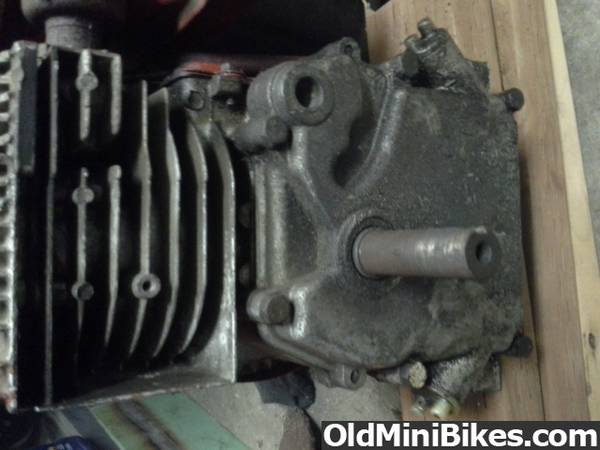

Hi all,
Received this old 3HP in the mail today. The engine is presumably one of the really early 3HP's in the 80000 series (kool bore) to come out. It has an aluminium bore (1958-1977), with the 3-leg coil, and decal on the side of the motor (barely). It also has a rare crankcase cover that would only release on early motors. It has an early type Pulsa Jet Carb that works surprisingly well. It is rare to see a 50-60s engine with a larger tank too. :thumbsup:
This motor has been sitting for 15-20 years in a shed, but it only took 30 minutes to fire it back up :laugh: A points clean was all it needed. Oh yeah, the shaft is too short for a clutch, so I will have to go on the lookout for another crank :no: (If anyone has one, 3/4 preferably with threads PM me).
I was planing on giving this motor the typical resto-job, but with different paint this time. I saw some of that Duplicolour Metalcast paint in red that I am really interested in using on this engine :thumbsup: It is quite metallic so it will sort of be a hod-rod paint job (I hope).
New piston rings are needed as it smokes some, and looking at the oil on top of the piston, it would be silly not to put new ones in.
I'm not sure whether to paint the block silver with red tins, or do the whole thing in metalcast...:hammer: The metalcast is good up to 500f so I'm not too afraid to do the whole engine. I'm wanting to retain the red colour, so whatever paint I go with would have to be red.
Let me know what you think.
-Jack
