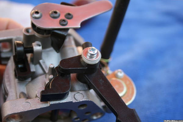

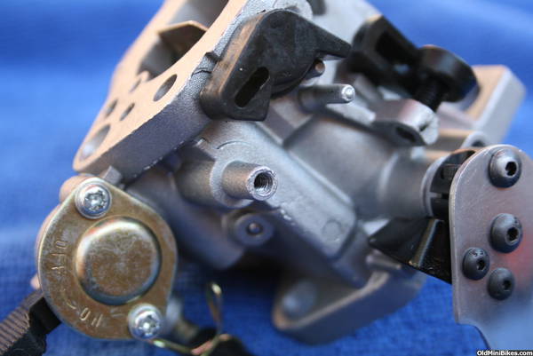

I wanted a different way to put the choke lever on a clone carb without the bracket so I could choose whatever air cleaner I wanted....and here's what I did!

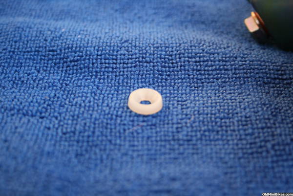

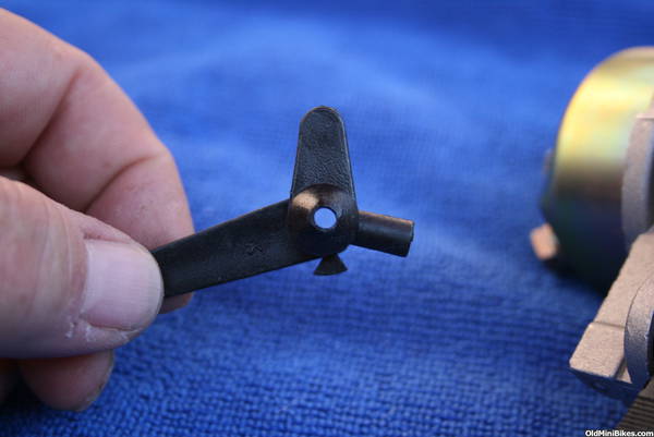

I drilled an tapped the choke boss for a #8 screw and drilled a corresponding hole into the top of the choke lever. I used a tapered nylon "finishing" washer on top of the lever, lubed it up, and put the screw and washer with loctite on the top. This functions very well and is a simpler look...whaddya think?
