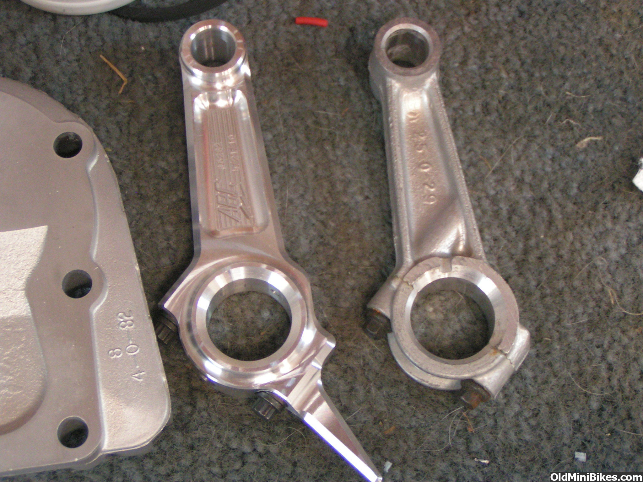

I have a HS 50 that will turn 6200 with no problem . It has a dyno 255 cam and a ARC billet rod in it like the one OLE posted a pic of . I'am running a stock carb slightly modded . It's the one on my Powell in my avitar .
