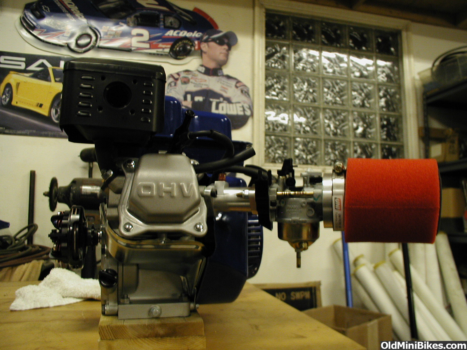

Not really to much power, but it is very big and heavy.
But your frame must be modified, or built just for that engine. Your motor plate needs to be at least 3" wider, and 1" longer.
Also the clutch will need to be 1", which cost a bit more than the regular 3/4".
