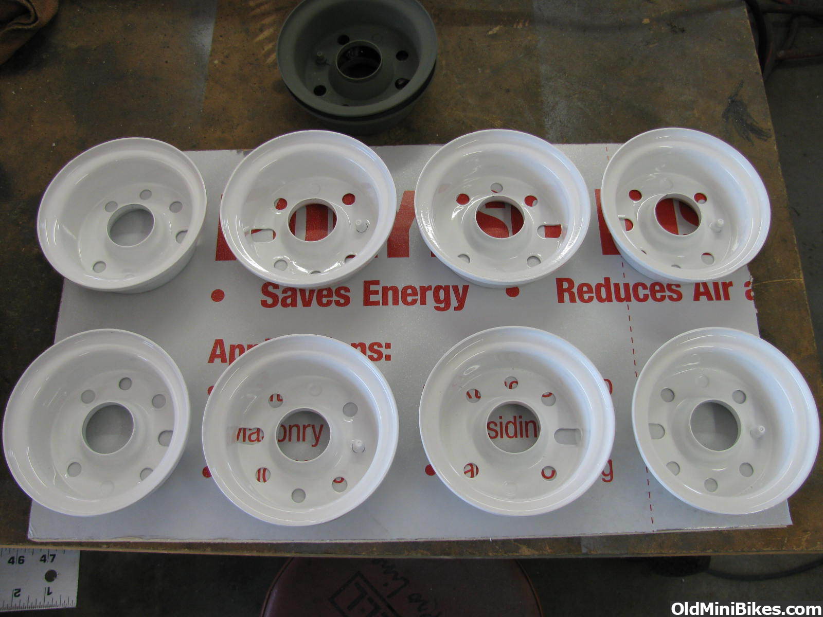

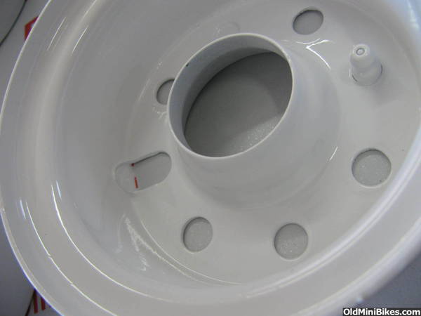

Been trying to get these off my bench so I can finish an engine and and a bike for some others, warmed back up this week here in FL so I broke out my paint gun, mixed up some Fulthane single stage automotive paint and hit these with some color to get them done finally.

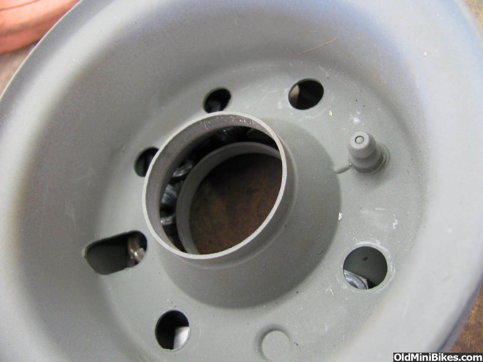

this is a verified original complete wheelset off a late '67-early '68 built Lil indian (date code on the OG tires were late summer 1967) and what parts they originally consisted of:
A painting tip note shown above, half filled water bottles out of the recycling bin make great stands to paint these :thumbsup: Wear a glove so you dont paint your hand and just hold the bottle up and turn it as you spray. when you are done with the coat on that wheel set it on a flat surface and pick up the next one.

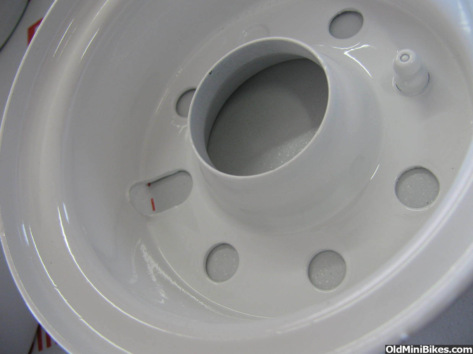

These are grease able wheels, the original ones had Heim bearings, both sides in the front and open side only in the rear, there was a solid bushing on the wheel halve behind the sprocket, only to really help center and keep grease in the hub section. The sprocket then got a sealed bearing pressed in. This helped keep everything centered and rolling smooth. These are all the original parts and again verified that this is how they came if you look on the early Lil Indian parts listings. Most people will replace the bearings with sealed, this set is super clean inside and out, no contaminants were in the hubs and still roll smooth even after grease cleanout so I plan to reuse them for originality.

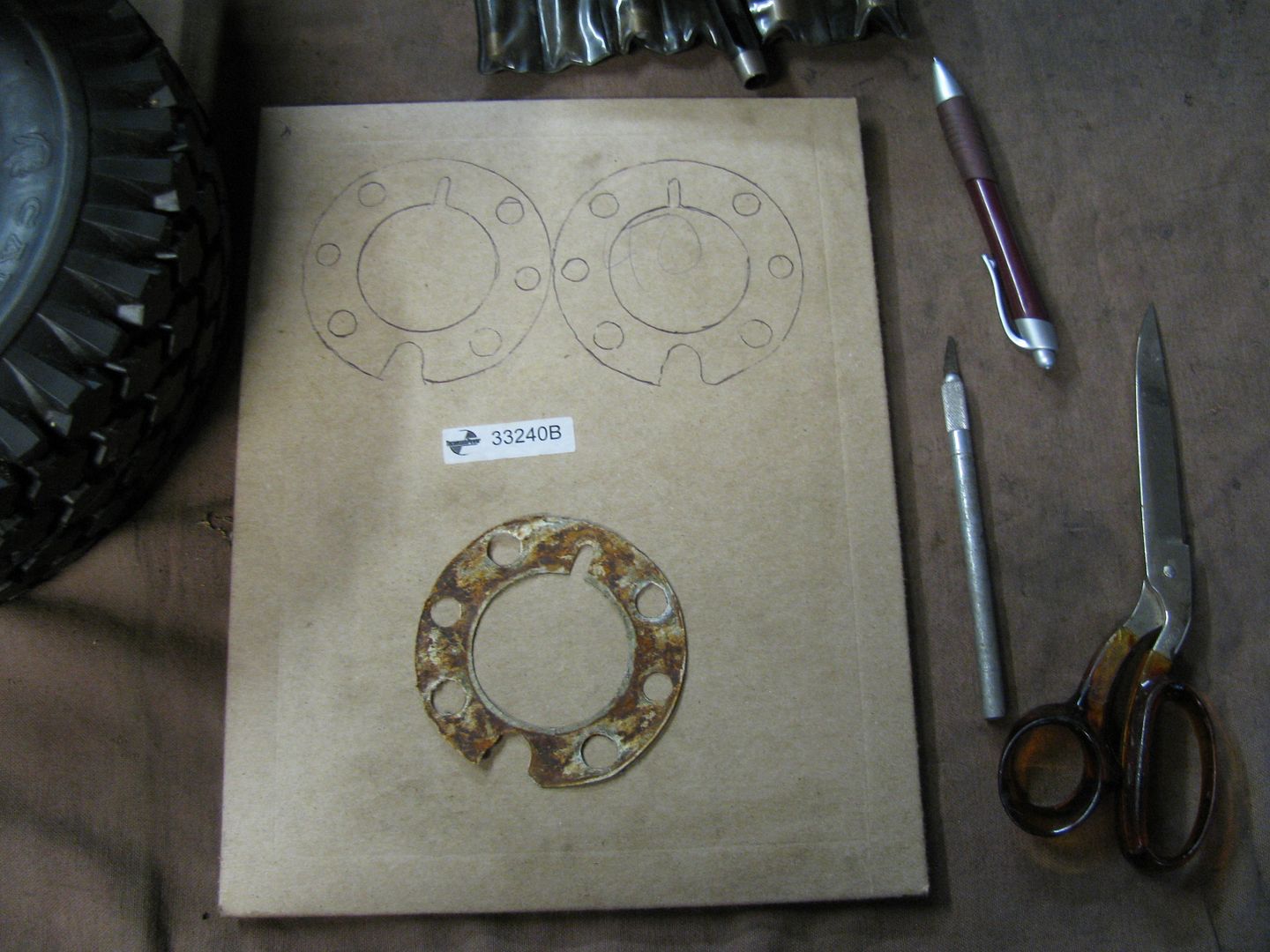

As you can see above I also made new gaskets, I looked and asked around and could not find any listed anywhere, again most people use sealed so they just scrape off the old gasket and bash the halves together and call it done. thankfully I was able to get one off in one piece so armed with a pen, exacto knife, scissors, and a hollow hole punch I made some new ones....Donor material was the thin cardboard envelope that Tecumseh gasket sets come in as of lately, Keeping it in the mini bike family :wink:
