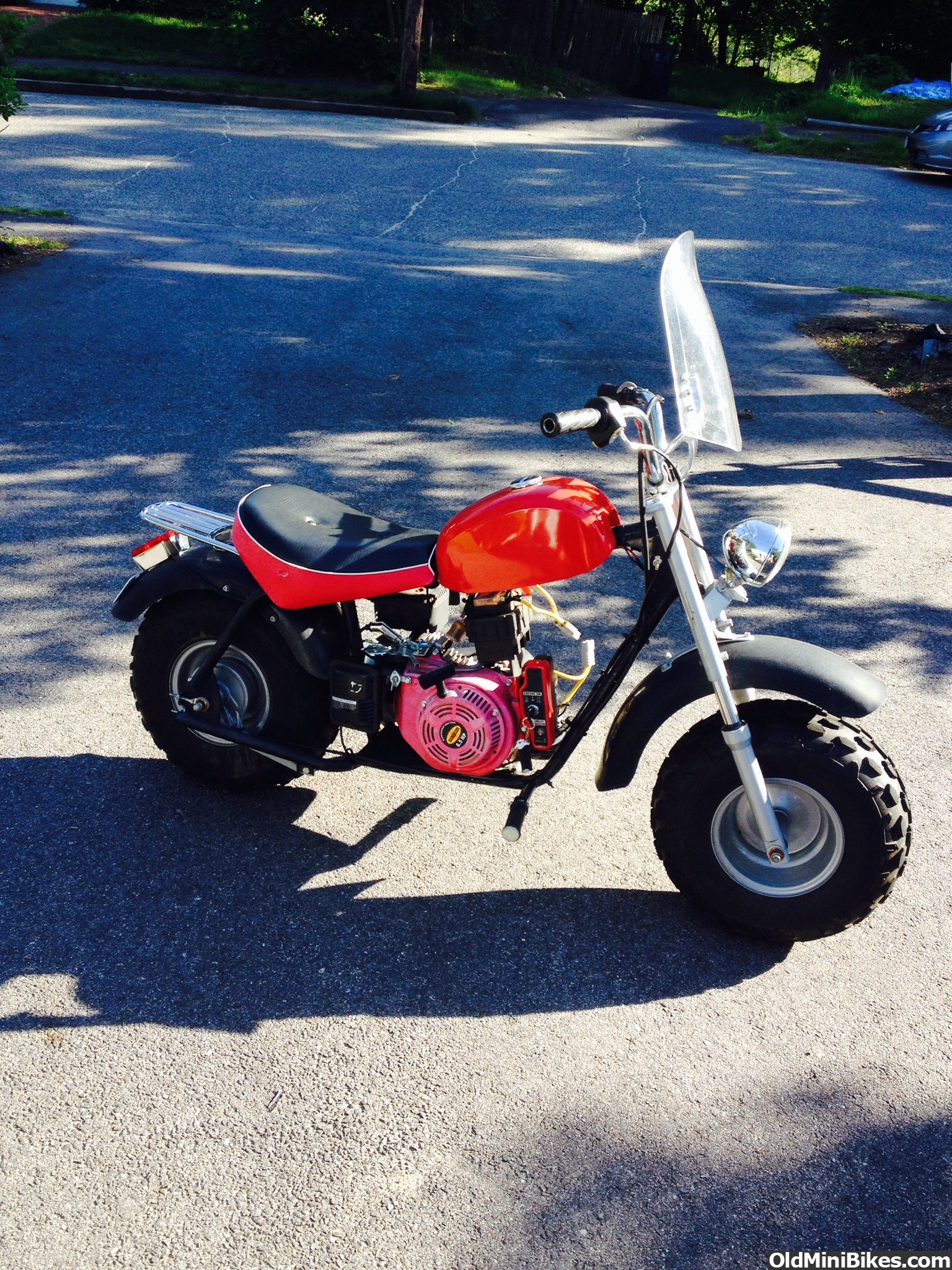

I posted my solution awhile back and will try to add the pictures again. I found that the tanks on a Pagsta Choppa are nearly identical in shape. Mounting is a little different but easy to overcome. I also believe, but did not conform, that the Honda Shadow tanks are a good match. You can get reproduction one off e-Bay for well under $100. The biggest issue was having to grind off the front bracket for the seat.
