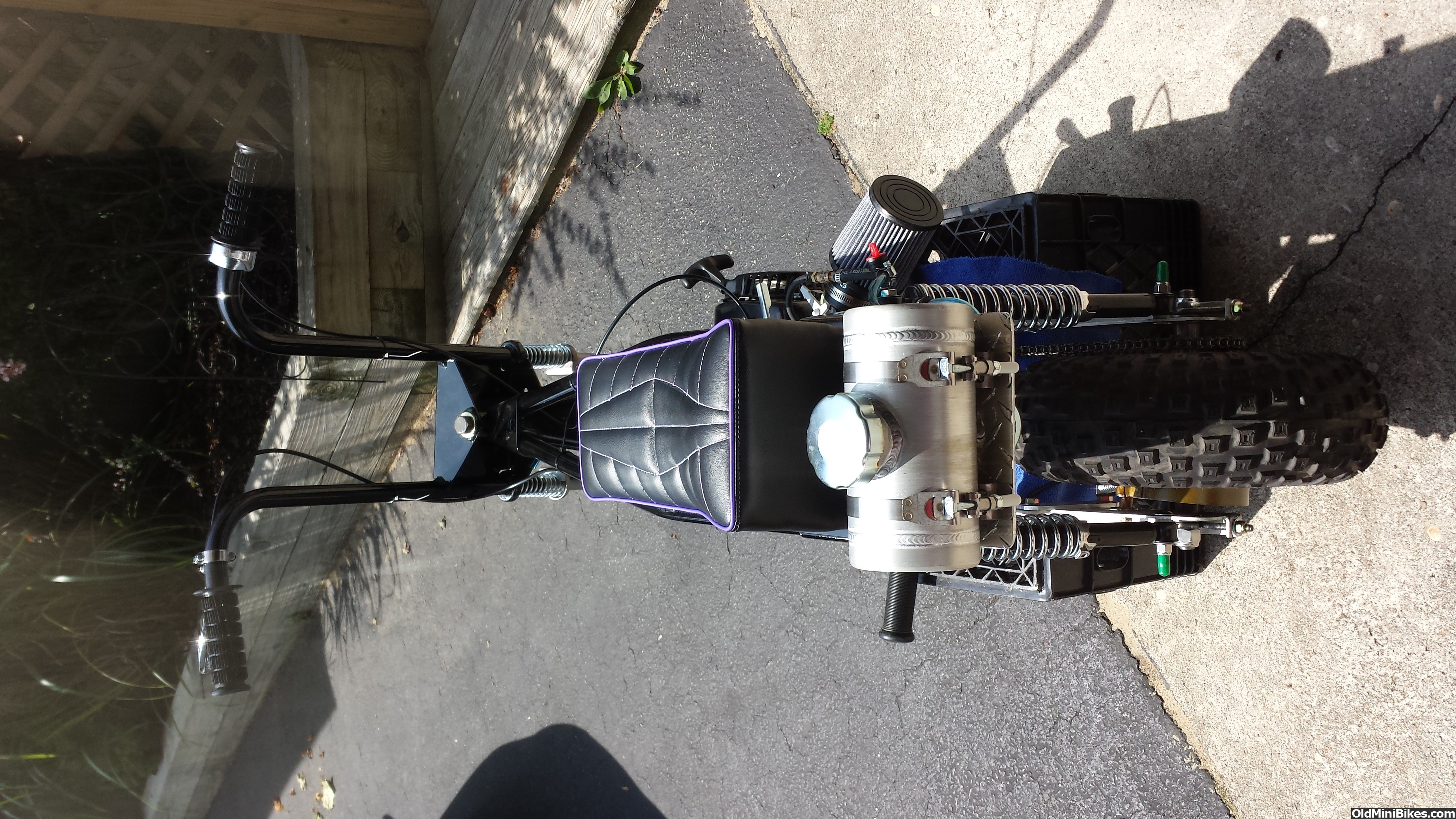

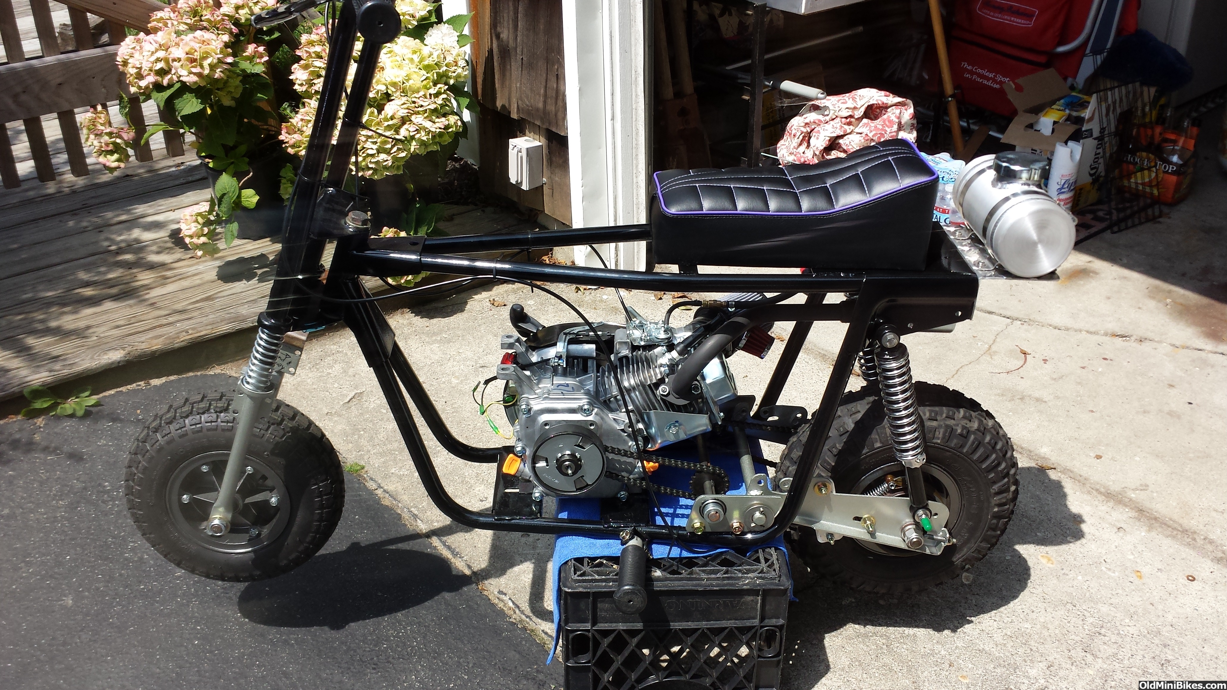

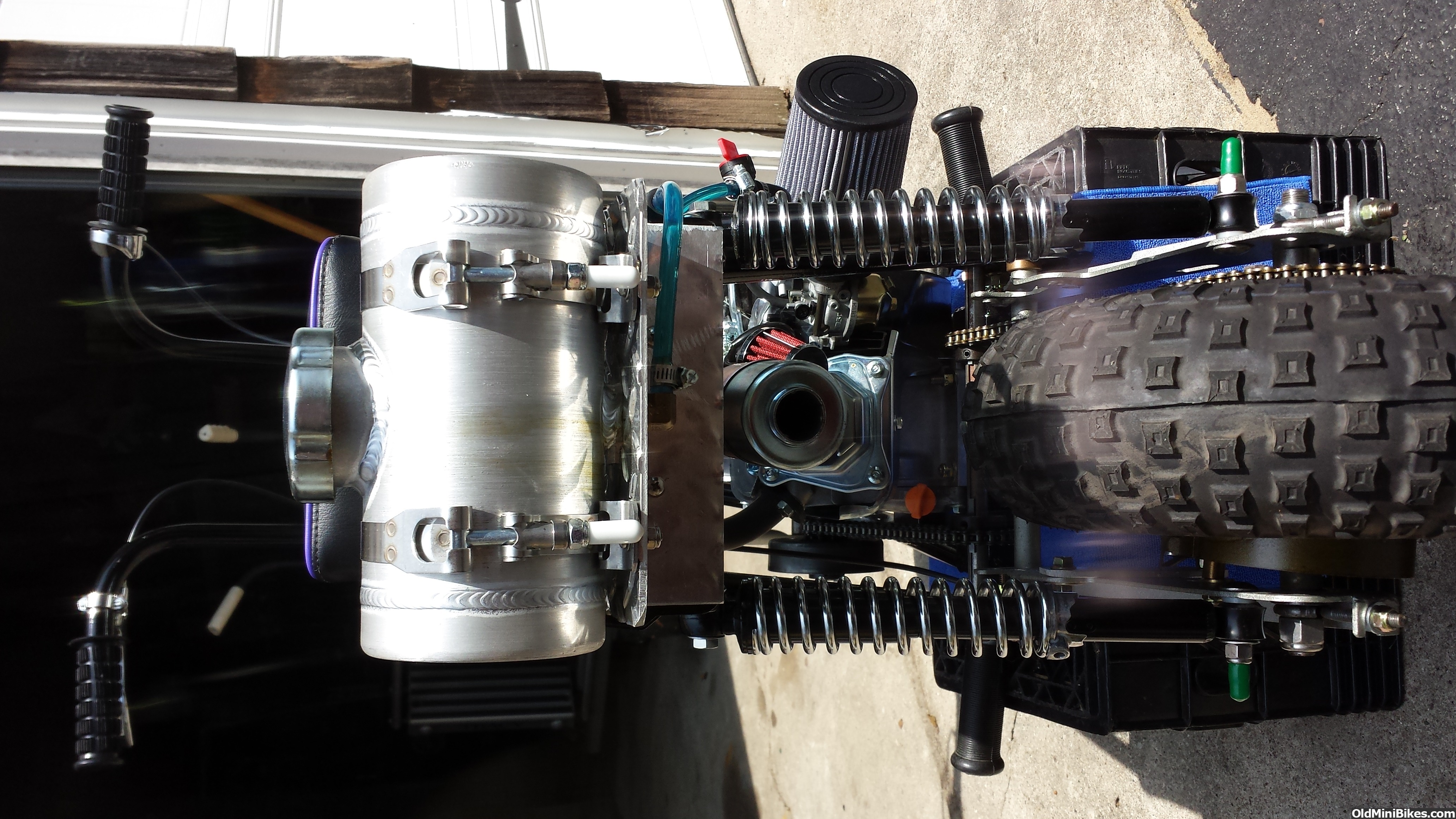

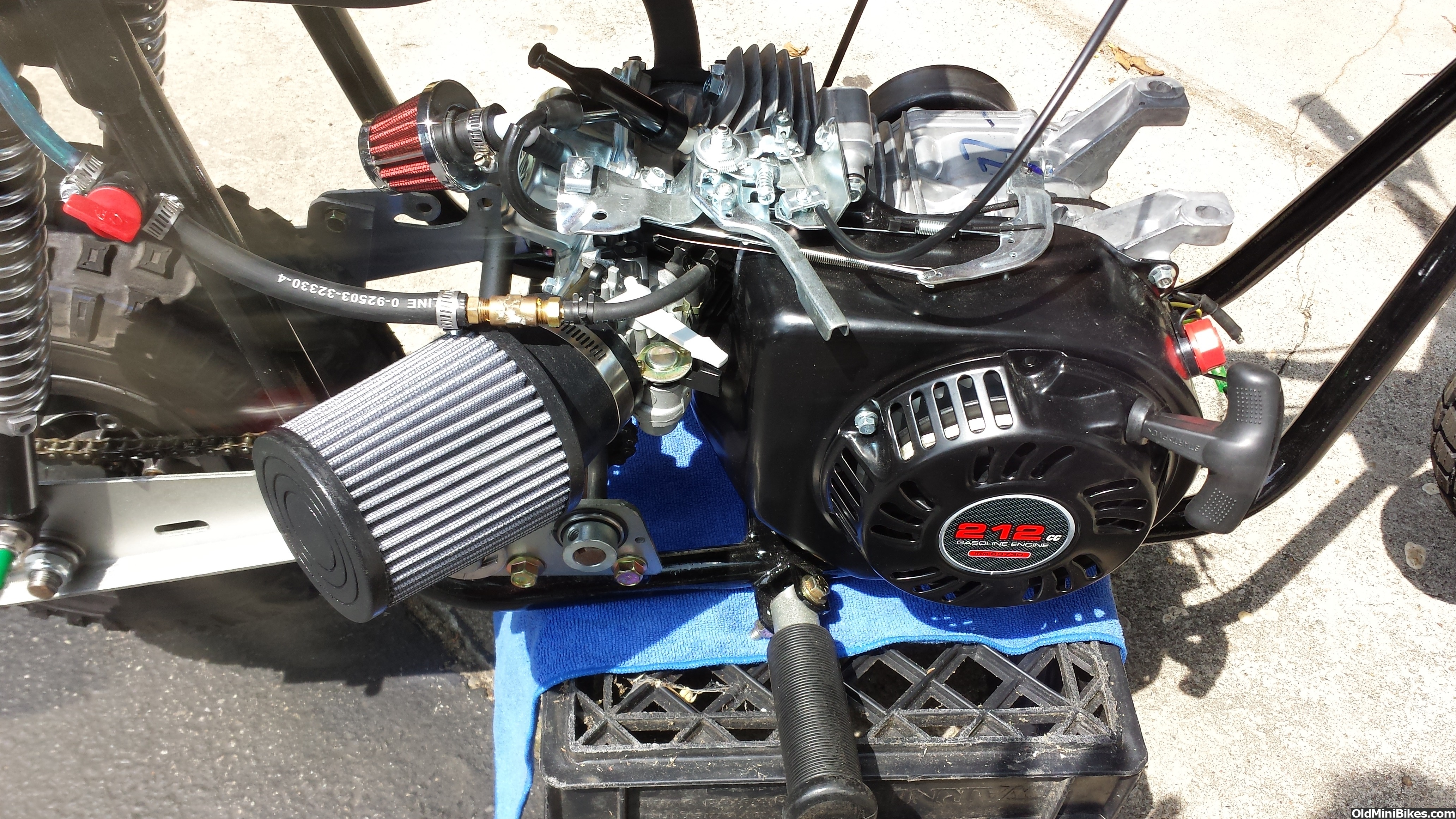

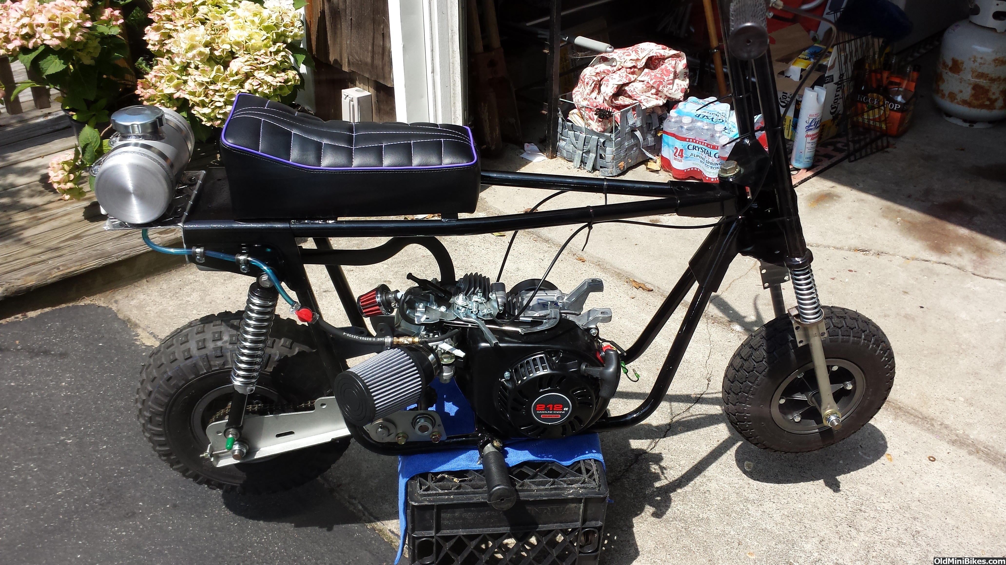

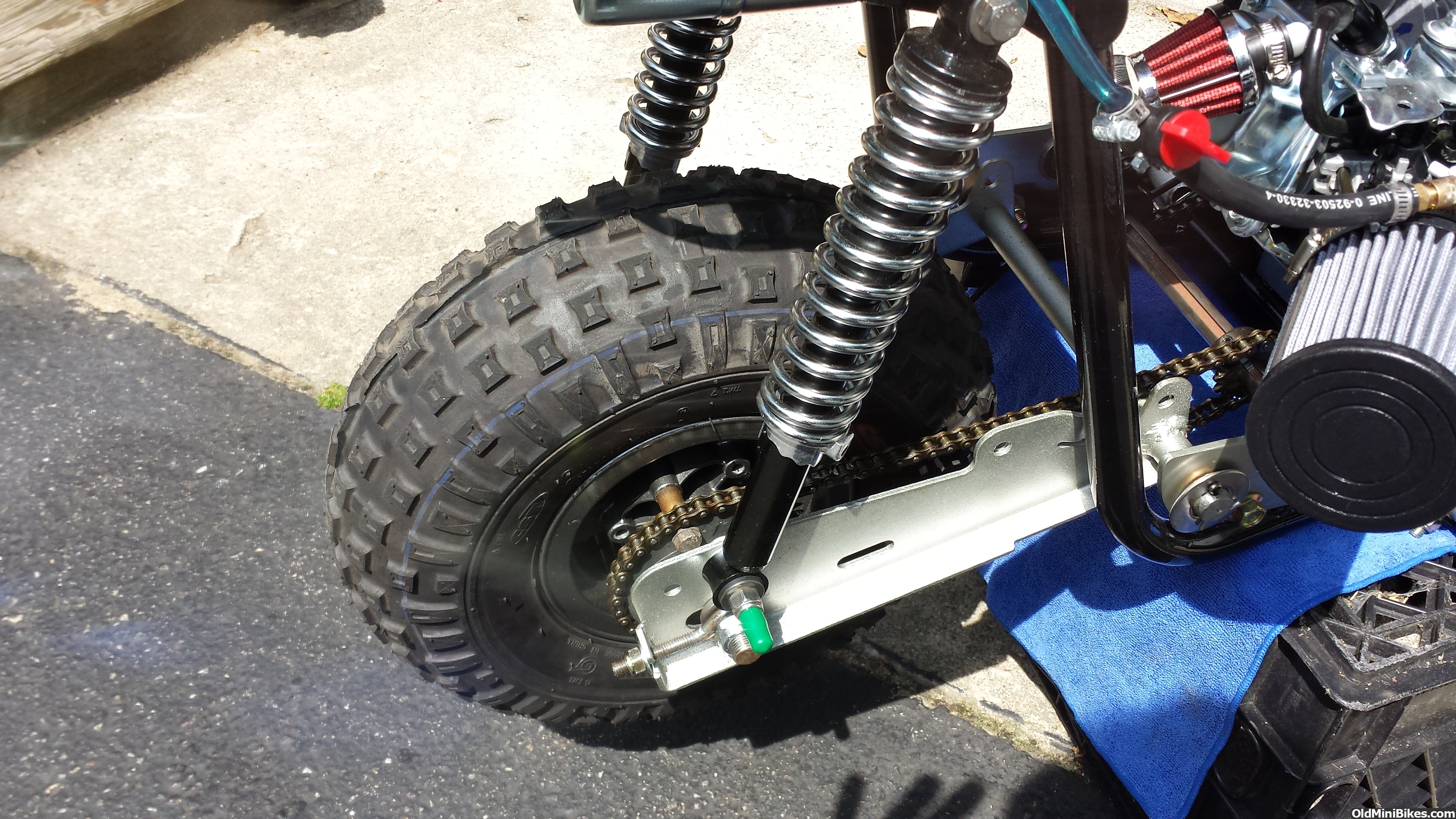

Finally Done! This was my first build, brought me back to my youth! Started as a garage sale buy (see my albums) Added shocks, new seat, had to rebuild rear brake. I kept the B & S for a later rebuild and threw a Harbor Freight engine. Kept it basically stock, added air filter, carb jet & emulsion tube, Champion plug and backed off the governor adjustment screw. Bike runs great, needs just a few tweaks.

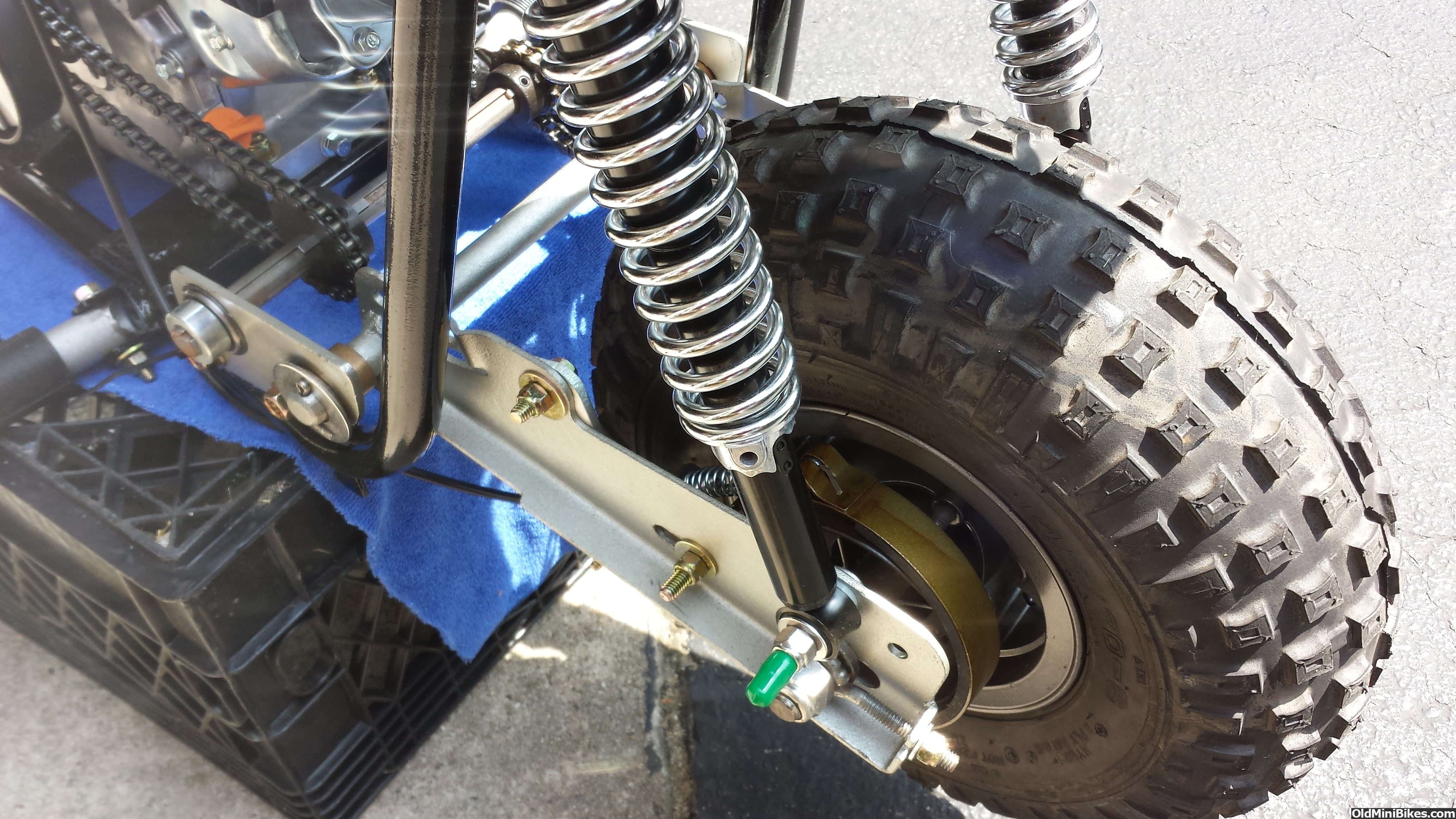

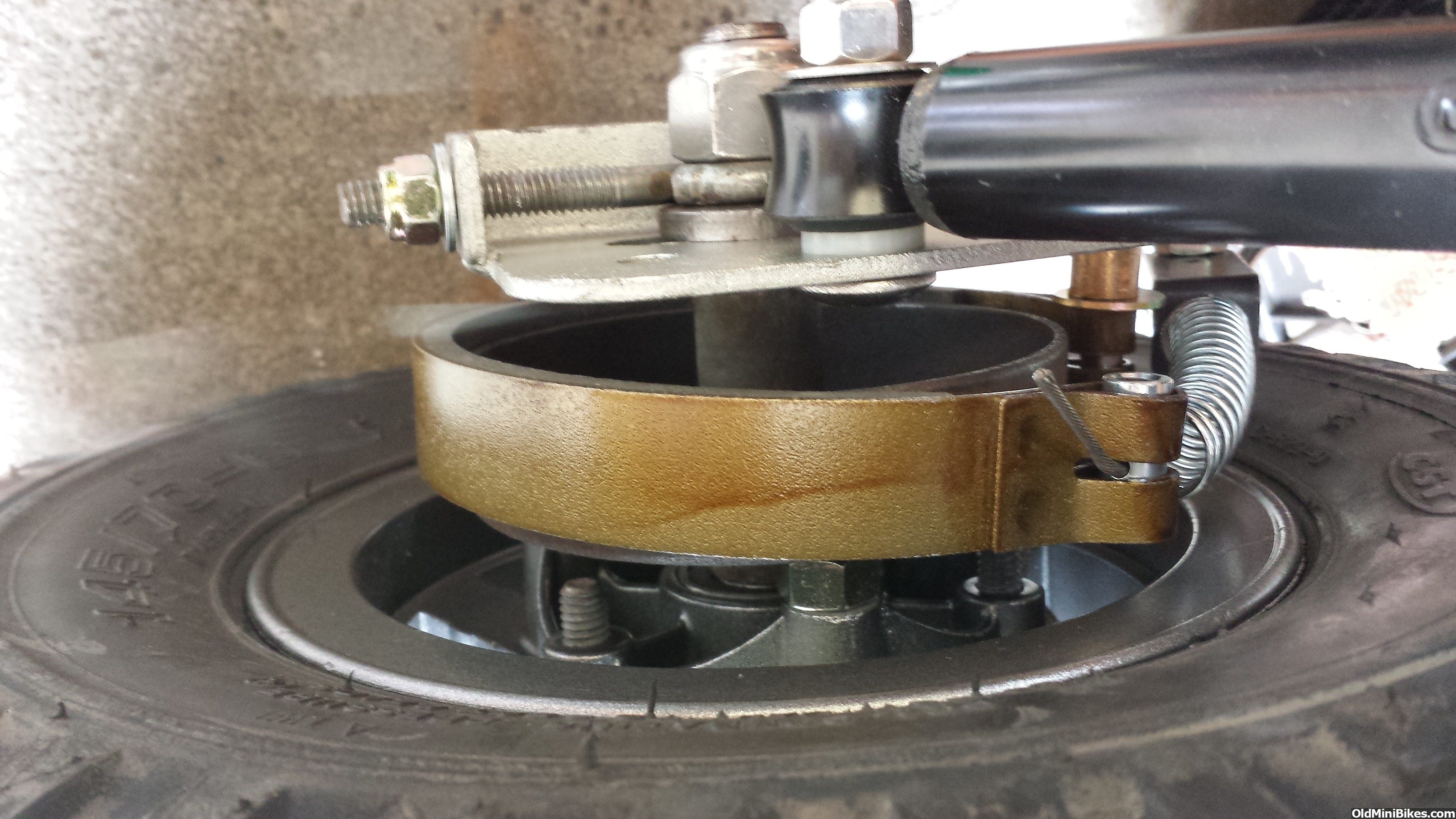

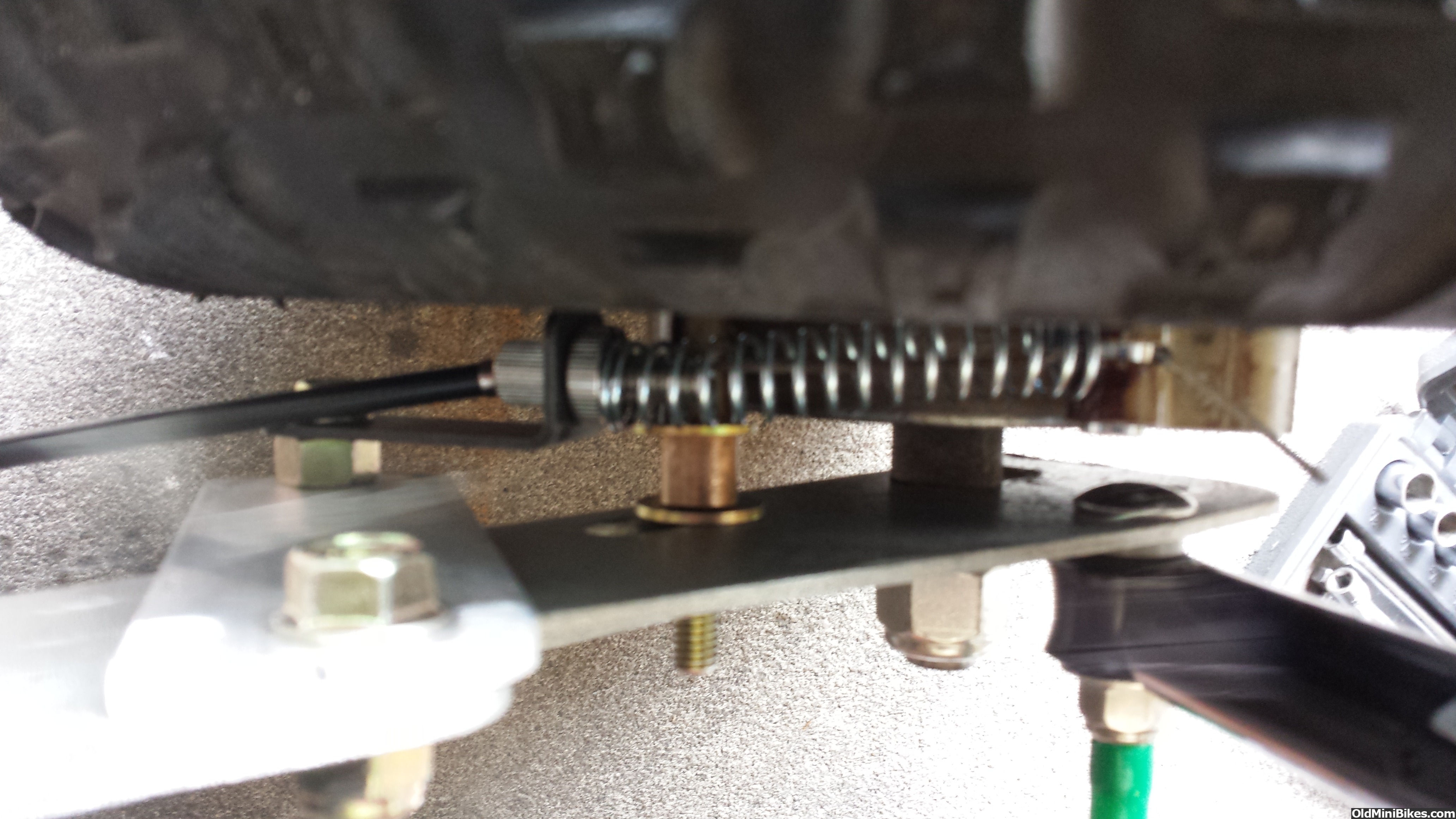

This bike had no brake when I bought it. The original equipment had a press formed lever that controlled the band. I made up this set up myself. As far as stopping power...its ok, not great. I have a bit more fine tuning to do.
