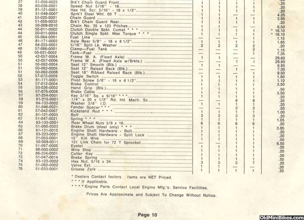

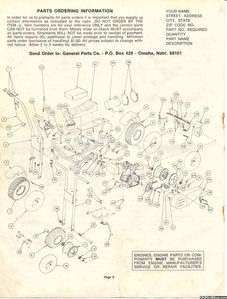

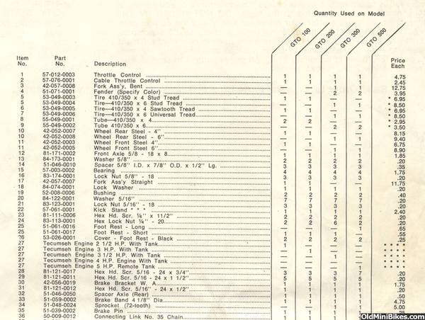

I know the brochure picture does not show fenders but many things on the brochure pictures aren't always as they came in real life. The GTO 700 above the 500 only has one fender on the front which I'm sure it would have come with both fenders. My Service Manual and Parts List shows that the GTO 500 came with fenders. You can also see everything else that was on the bike.
