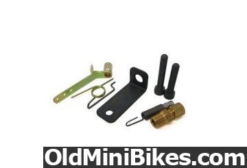

I wanted to post up some info, as I could not find much info on the kit I installed for my throttle linkage from OldMiniBikes warehouse: https://www.OldMiniBikes.com/predator-engine-throttle-kit.html?category_id=1086
I previously had the below kit, cheap: I was on my 2nd kit for this bike, this setup is not smooth, and my throttle kept sticking, not good :censure:
So I had been hesitant to buy the new kit from OldMiniBikes warehouse, as it was $30, and thought I could make my own, but time is money and I bit the bullet and bought the kit from OldMiniBikes, and am glad I did. This throttle kit is super smooth and works awesome. It is initially setup to work with a governor so I had to use a lever off of a top plate I had lying around. The original lever would work but for a governor setup.
Original Lever
My modified lever
Close
Had to bend the rod and add a return spring
Finished product:
I am very happy with this setup and would highly recommend it. It would be a bolt on deal if you had a governor and hooked straight to it. Modifying it as I did did not take much time at all.
