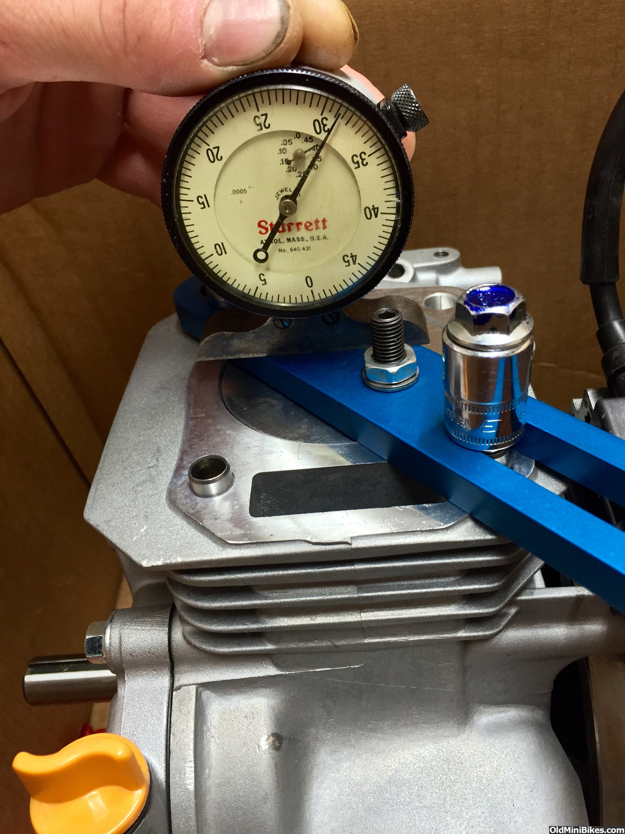

Well I just cracked open my brand new Hemi Predator and like you said.... The piston is a little over 30 thou in the hole.... Actually my piston is .032 below the deck To be exact.
Yup, with that one use a .040 rod and a .040-.045 gasket and you will be running as close,as you would want to for piston to head clearance...
