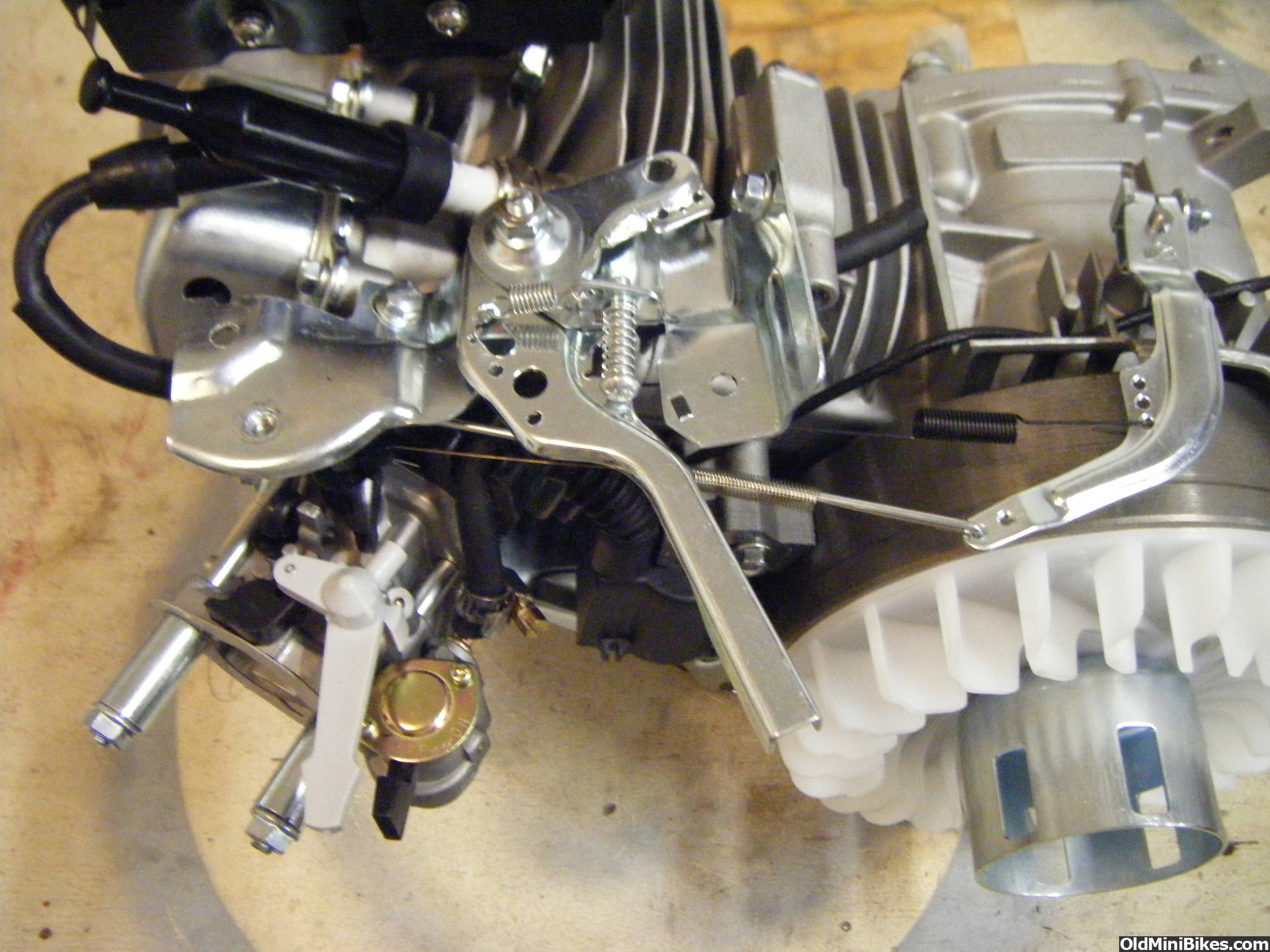

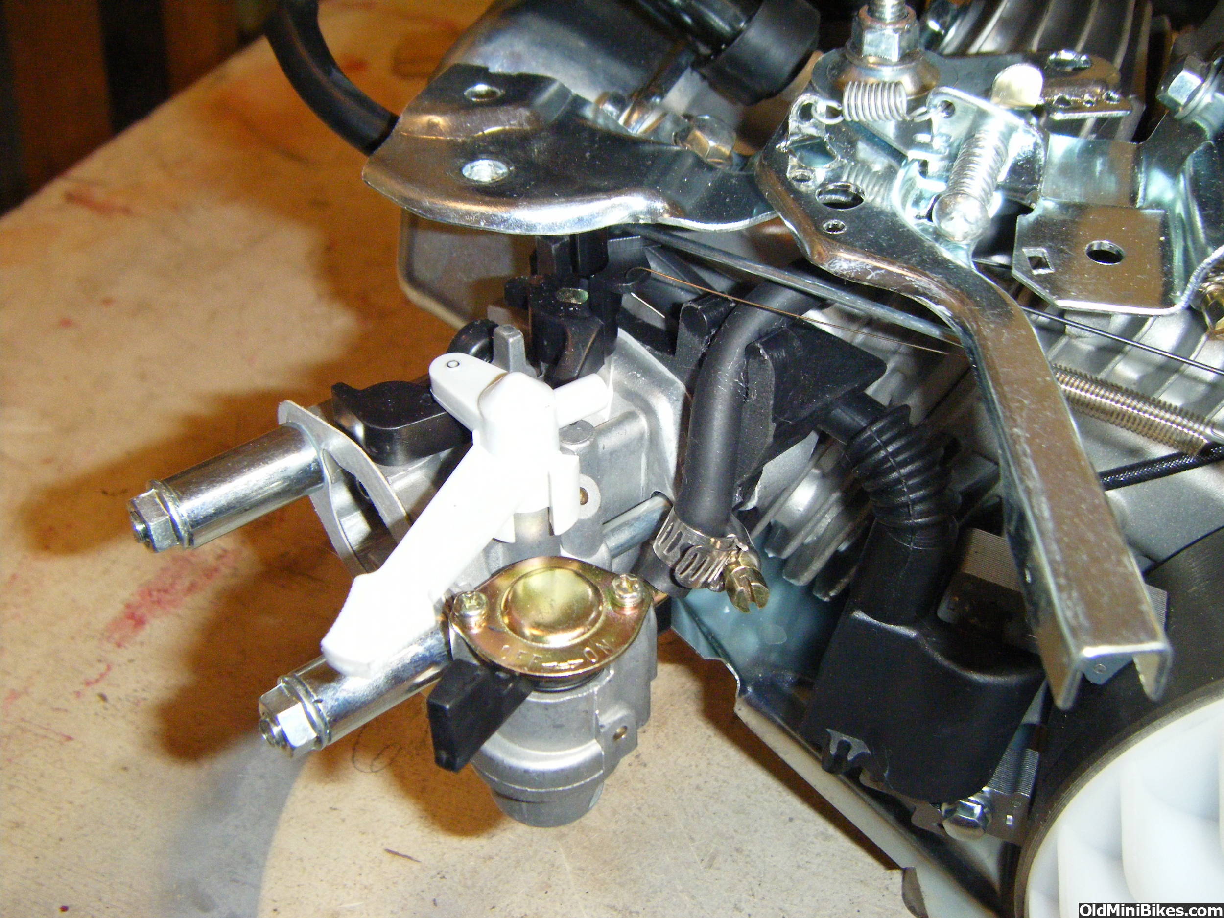

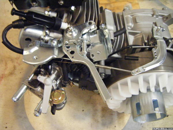

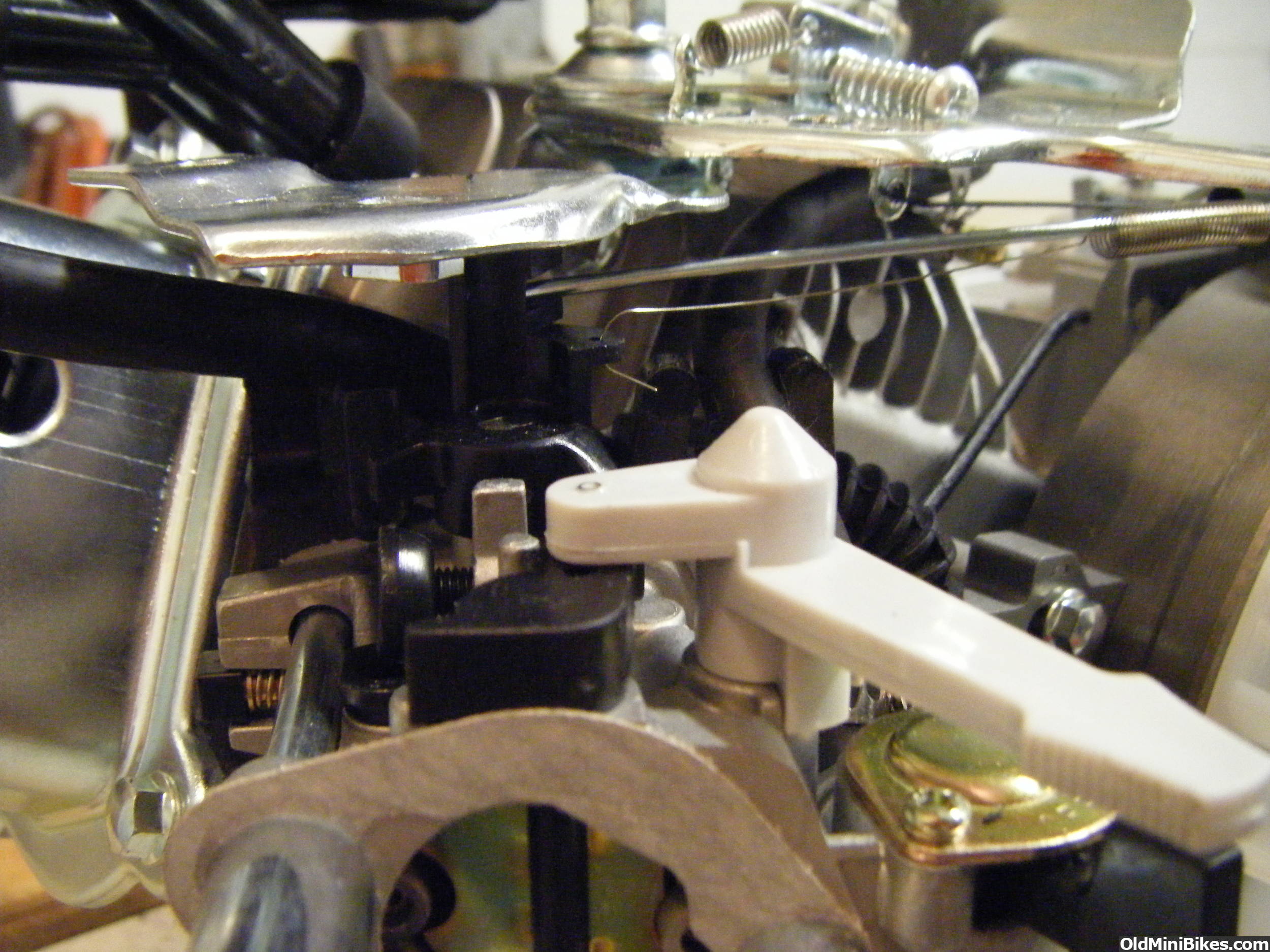

I think the engine in the Baja Heat/Warrior are similar to the Harbor freight 6.5hp clones. I went out to the garage and took some picture tonight of the new 6.5hp clone I just got, This is how the linkage was set up from the factory. I hope these pictures can help you out.

The bike is the MB165 and it probably had a Jin Dong clone from the factory. The throttle is cable opperated and moves the regular throttle lever on the engine.
If you moved the location of the governer spring from one side of the three holes ( used to adjust sensativity of the gov ) to the other this can affect the idle RPM. Some engines use different spring than others. Generator springs run at a higher idle for some reason but are the same length ( I don't know why ).
So try moving the spring from out to the holes further out on the govern arm and see if the idel speed drops. I have mine set to idle around 1500 rpm. I also run two springs one slightly longer and stiffer than the other to let the arm come all the way back and sit on the idle screw but when I twist the grip the stiffer spring lets me rev up to my top speed at 4700. I have a box of gov springs and no two seem to be the exactly the same. I had to try a few to the pair I use.
I had the same problem with my Lifan clone and just had to keep trying different springs and governer arm holes untill I found a combination that let the shutter close right down at idle and then pull all the way up to my desired speed.
There's also the rod that connects to you gov arm nd carb. You might have that in the wrong hole as well.
