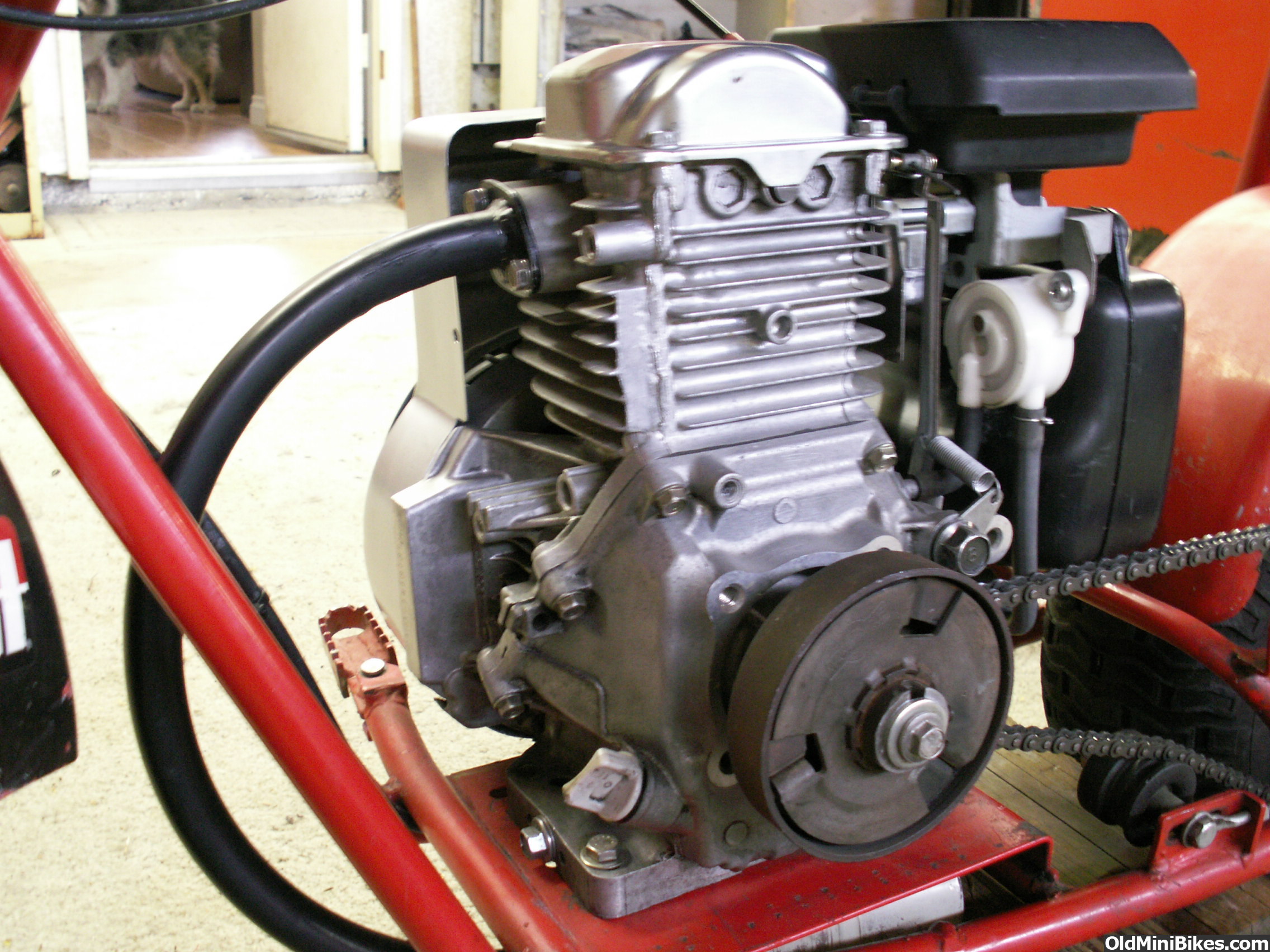

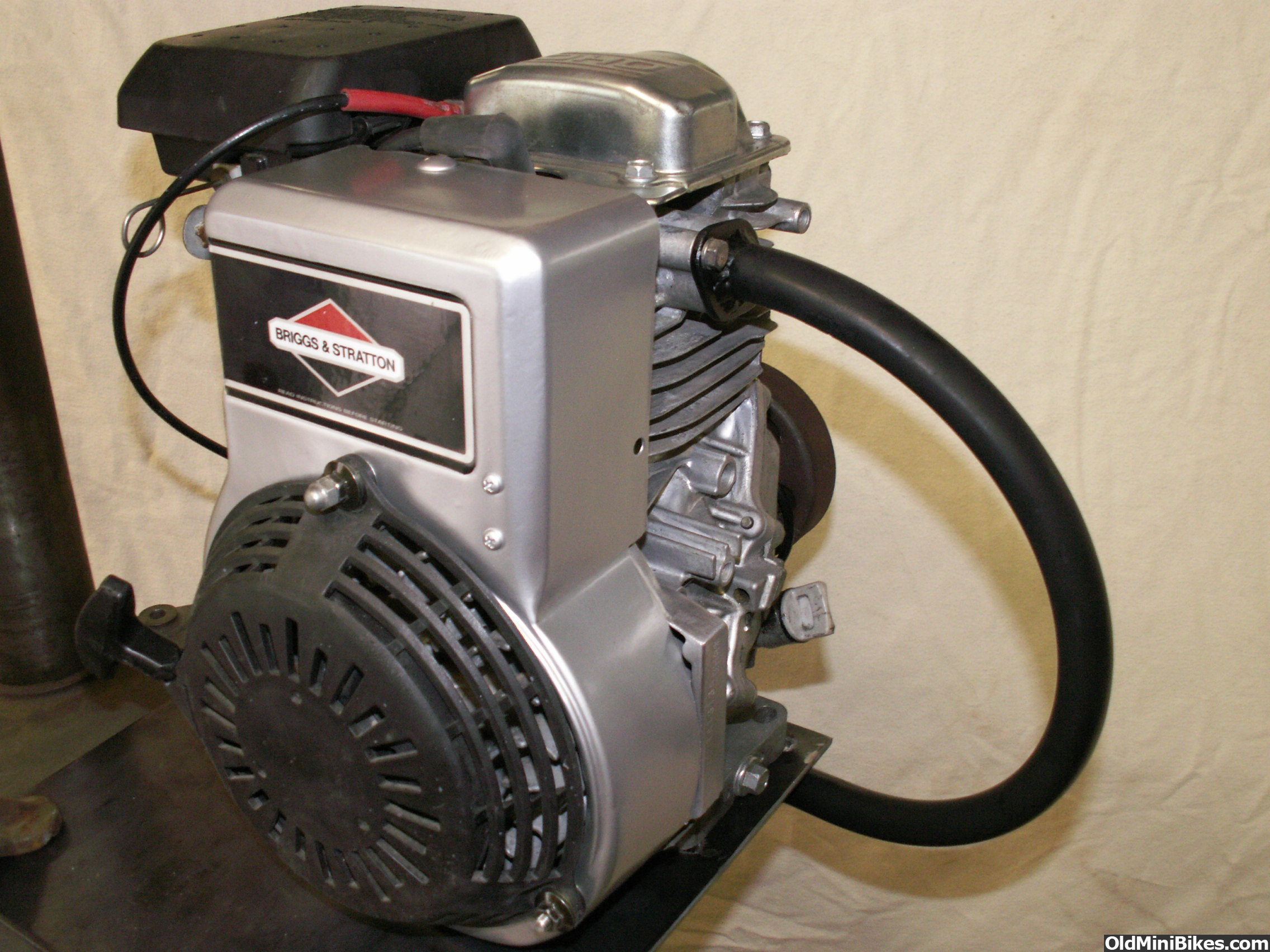

ohv=ugly flat head= cool looking
a four stroke engine is basically an air pump. so the more air you can pump into the cylinder for a given displacement the more power you can make. OHV's are better at moving air just by there design. so if you can get past the ugly ohv's put out more power.

and btw- nice motor there neck -freezerburn
