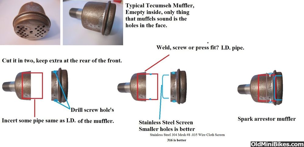

I'd take my muffler apart, put a stainless screen 0.023 in it then put it back together.
With any luck, ya might be able to do it so its easy to take apart again, for a new screen or cleaning.?
Ex;
An No, I have never done this. So its pure Idea. ( correct Screen size 0.023 )
Did some research;
Forest Service Standard 5100-lb fall into a special category. They are intended for use on small engine applications. All exhaust products must pass through the screen, which has openings of 0.023-inch or less. the effective exhaust area of the screen (total area of all screen openings) shall not be less than 200 percent of the engine exhaust port area at its smallest cross-section. Screen material shall be heat and corrosion resistant, and shall provide at least 100 hours of service life. These are originally qualified for all the positions described in the "Application Positions" section.
