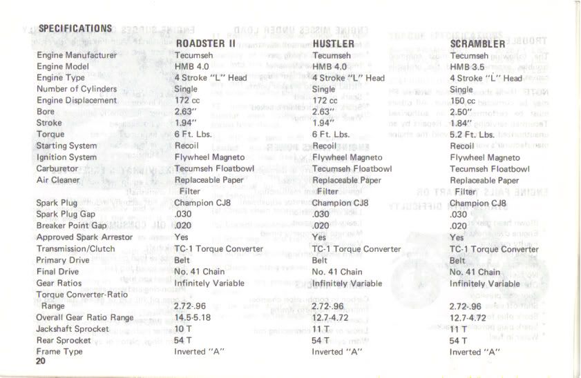

Hey guys, I have another question. I have a 1971 Rupp Roadster II. When I bought it a couple weeks ago it had the Champion something like J19LM sparkplug in it. I posted on here and now I know the J19LM is for solid state ignition and the CJ-8 is for the points ignition.
My question is how do I know if I have points or solid state ignition?
Becuase I don't know for sure which sparkplug will work?
Will they both work if I have either ignition?
And why would the J19LM be in there if it was the points ignition, is it easy to put the wrong plug in there?
