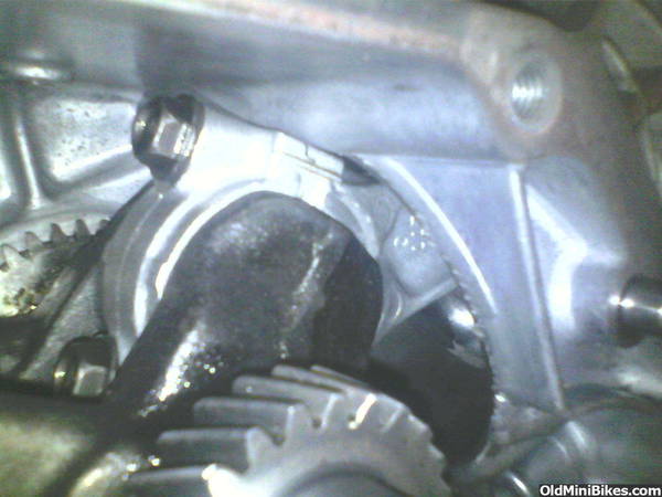

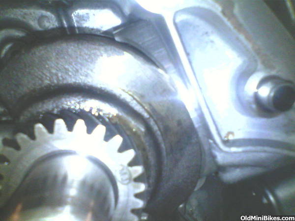

Ok so there are multiple problems with using stock or stock size stuff !!! first is the crank hits the piston skirt . second is the rod hits the top of the block hard from what i can see block would definitely need support to clearance as much as it would take . and the pop out is right to the first ring :thumbsup:

OK so here is where I'm at and kinda stuck for now. I had the piston cut but they couldn't cut it as much as I wanted due to the recess in the center on the bottom side. There was only gonna be .022 of material left, so I had them cut it to leave .075. Well this puts me .060 out of the hole which would take a lot of head gasket to make up. I need to find a shorter rod or maybe a small spacer. I know people have cut the head to accept the piston for pop up, this may be my next trip to the machine shop. Oh ya I do need to clearance the block for the rod, don't know what happened during the first mock that made it look like I didn't need to clearance but I do.
