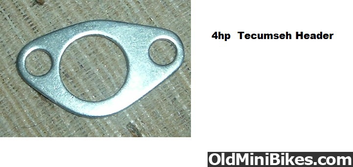

Hello OldMiniBikes, I don't know about You but, I have had a hard time finding A Exhaust Header blank.
So I finally find a blank from a friend. Correct blank to build a Header for a 4hp Tecumseh.
What a thin 16 gauge POS is what is but, it is a perfect template. So I checked today with an outfit
that can laser cut and Re-make these plates in 3/16" steel ( A real header ). I'm looking at a Min run of 50 plates.
I need some but not all. So who is in for some ?
5.00 a plate shipped, We can work out shipping if you want more header plates.
If you want more, PM and we can work out cost's of plates and shipping.
Let me know what you think?

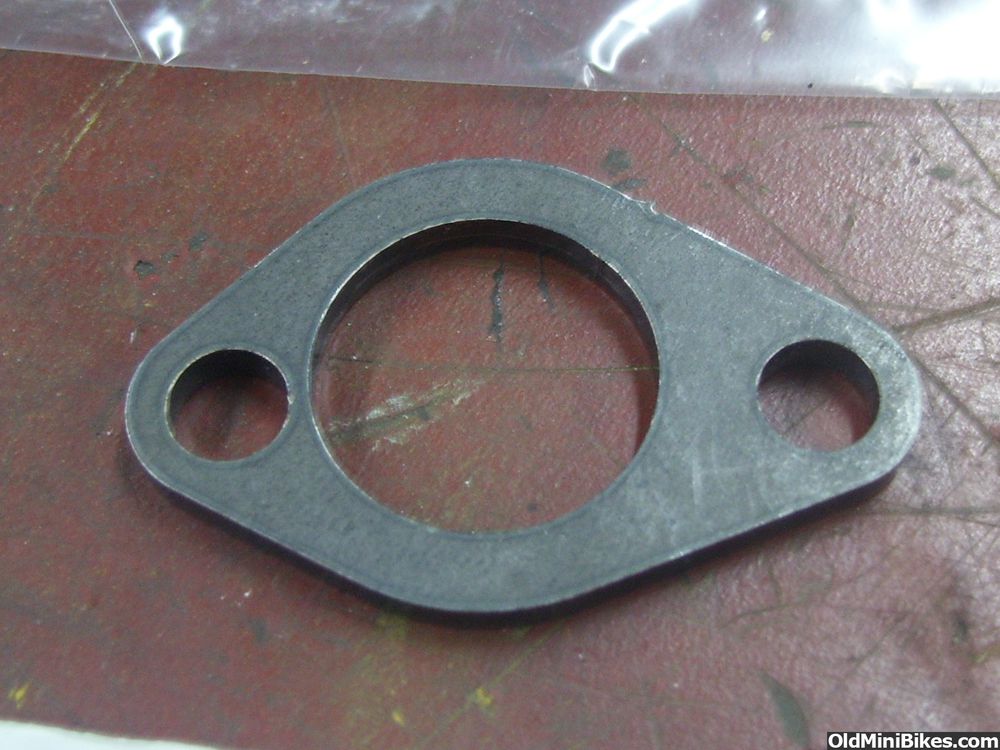

If you want a true match port, the Tecumseh part number #730163 is the HS40 repair flange, I sent one of those to my buddy to copy and burn of a stack of them for me.
They on their own are like 1/4" thick since they are threaded. I used a couple to make some exhausts before I had the ones cut in 1/8" by just reaming out the threads.
yellow paint is the Tecumseh part (actually a #730162, its exactly the same as the HS40 just the pipe threads are reversed since it its for the H25-35)
Just remember that the HS40 and the HS50 have the same bolt spacing but DO NOT interchange, so you need to either use #730165 as a pattern for that, or design a happy medium between the two, by morphing them together a bit.

Here's the cheap POS 16 gauge Header flange I got.
You might be able to weld it if you had a TIG and took your time as not to warp it :crying:

Do you still have some? I bought a Tec flange before seeing you'd already reverse-engineered a stack.
Yes I have a some, you can PM me if you need one. I make a similar to original H25-35 exhausts with them when I can score the muffler cans at an affordable price. I had them done in 1/8" for my small exhausts so if your building big heavy/long exhaust you definitely would want to run a brace or even just ream out one of the Tecumseh OEM threat saver flanges since they are so thick, The H and HS40 ones can be found pretty inexpensive, The HS50 ones are really pricey though!
The exhausts I make....not much weight or length to them:
