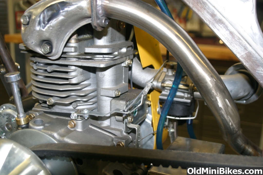

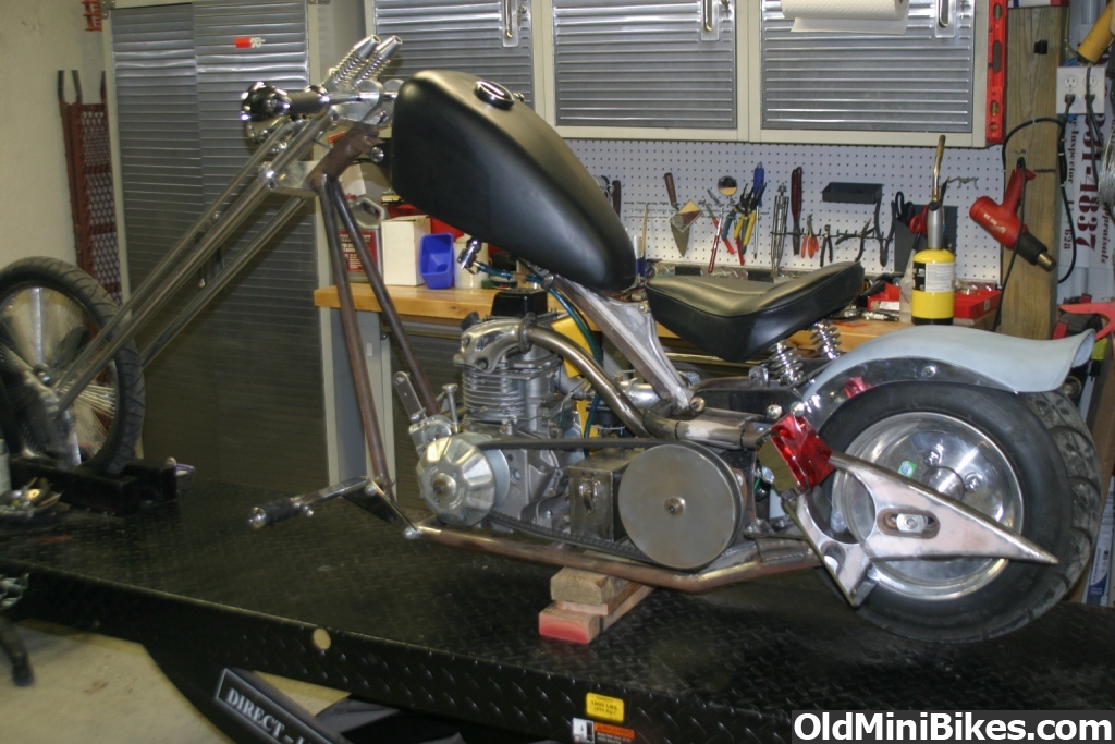

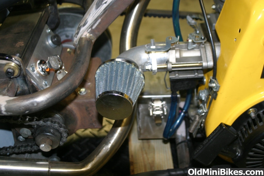

Just about done with the build and now I'm having problems with the stock carb. This is a brand new (old stock) motor. Ran fine about a month ago but now it only idles. Any throttle with the choke off, it trys to die. Choke on, rev's up...
I've never worked on this (new) type carb with the plastic float bowl (clip-on). I have cleaned it (a little, afraid to get rough with it). I have a filter on the new petcock AND inline. I've vented the tank & tested it for flow - flow a full stream of fuel. What the :censure: am I missing?

Good news! I found the problem... I re-cleaned it and again found nothing BUT I found that the center tube that likely acts as a main jet (does not have a real 'jet') was stuck down into the bowl. It has a spring in the bottom of the bore (in the plastic float bowl). When I pulled the tube out, it was firmly planted being held by two o-rings. When I reinstalled it, the tube floated up & down (from the spring tension) riding on the two o-rings. Turns out THAT is what it should do! Runs great now... Walbro is next and removing the governor. :thumbsup:
