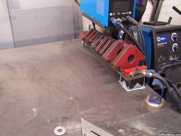

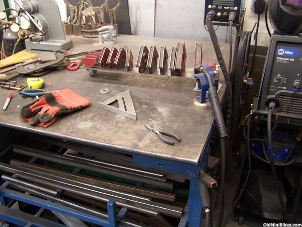

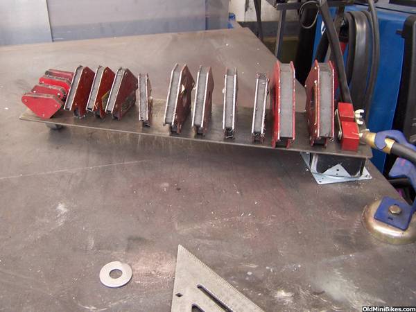

A few years ago I built a welding table and it is great! However, welding debris and grinding particles
are constantly getting all over my magnets and it is a pain; so, I bought a little metal wheel, a
lazy susan bearing and a piece of steel and today built what I think will solve the problem, and
allow me to move the magnets out of the way easily when I need the whole table.
