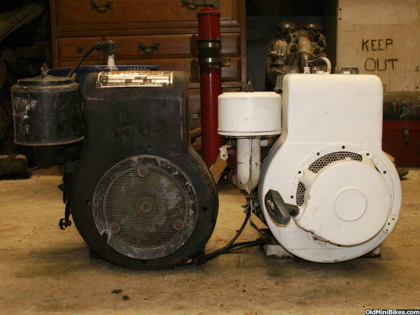

ANYBODY OUT THERE EVER HOP UP ONE of these old wisconsin engines ? heres my plan. the factory cranks a forged steel so there plenty tough and run on bearings not bushings,they have super long connesting rods so hi-torque isnt a problem.
1. weisco piston (slightly higher compression)
2. billet aluminum rod
3. gov. removed
4. crank- knife edged & polished then balance the rotating assy
5. billet aluminum flywheel
6. billet cylinder head
7. 100% port and polishing of ports
8. mikuni carb
9. isky cam,billet lifters and matching springs
10. stainless pro-flo over size valves (custom made)
these engine turn 3600 rpm,s stock so if i can wind it up to 5-6k on 93 oct gas i think 12+ hp and huge amount of torque will be possible. any thoughts ?
thanks
bob the experimentor
