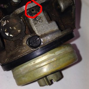

Thanks boss! i would have never thought to check out the float needle! turns out the replacement parts i got must have been for a different carb because the float needle was a different size even thought everything else fit :rolleyes:
I recently bought new replacement parts for my carburetor, and once i put everything together and plugged the guy back in it would start to leak oil. From what im pretty sure the source of the leak is coming from the little hole in the picture. Im currently taking it apart again to see if i...

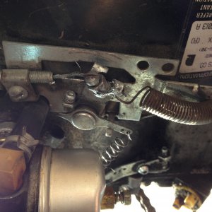

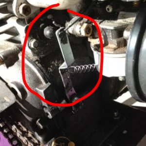

Turns out it had nothing to do with the throttle cable, i was right about it having to do with the clutch. the clutch key was missing! put a replacement in and the purp machine is running prime! :thumbsup:

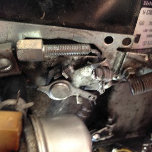

My current problem with the bike is getting the throttle grip to work.. it seems hooked up and when i give it gas she revs but doesnt move. the only way to get it going was by manually pushing in this throttle lever on the engine located under the exhaust.
any ideas on whats wrong?
