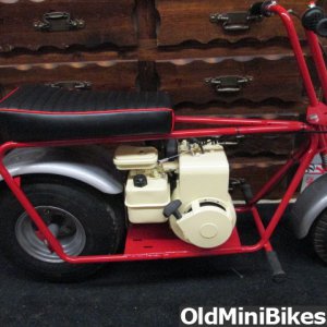

When I got this mini and motor there was no governor linkage with it.When I rebuilt the engine I reinstalled the plastic gear and all the governor parts. The only mods were the bore is .010 over,slight porting and I shaved the eyebrows and put in a raptor rod. The mods for next winter will...

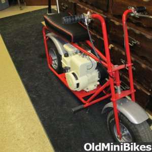

Just a big heads up to anyone that needs a seat for their mini. Kenny is the man!!!! He did a seat for my boonie and its awesome. Well worth the money. I'll post pics tomorrow.
Thanks Kenny.

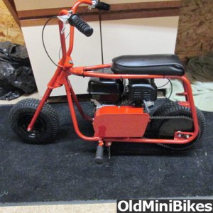

Here are pic's of the finished tank. I got it running Saturday and rode it Sunday. Darn thing will do a wheelie!
I still need the seat,kick stand and kill button. I'll have those this week.
