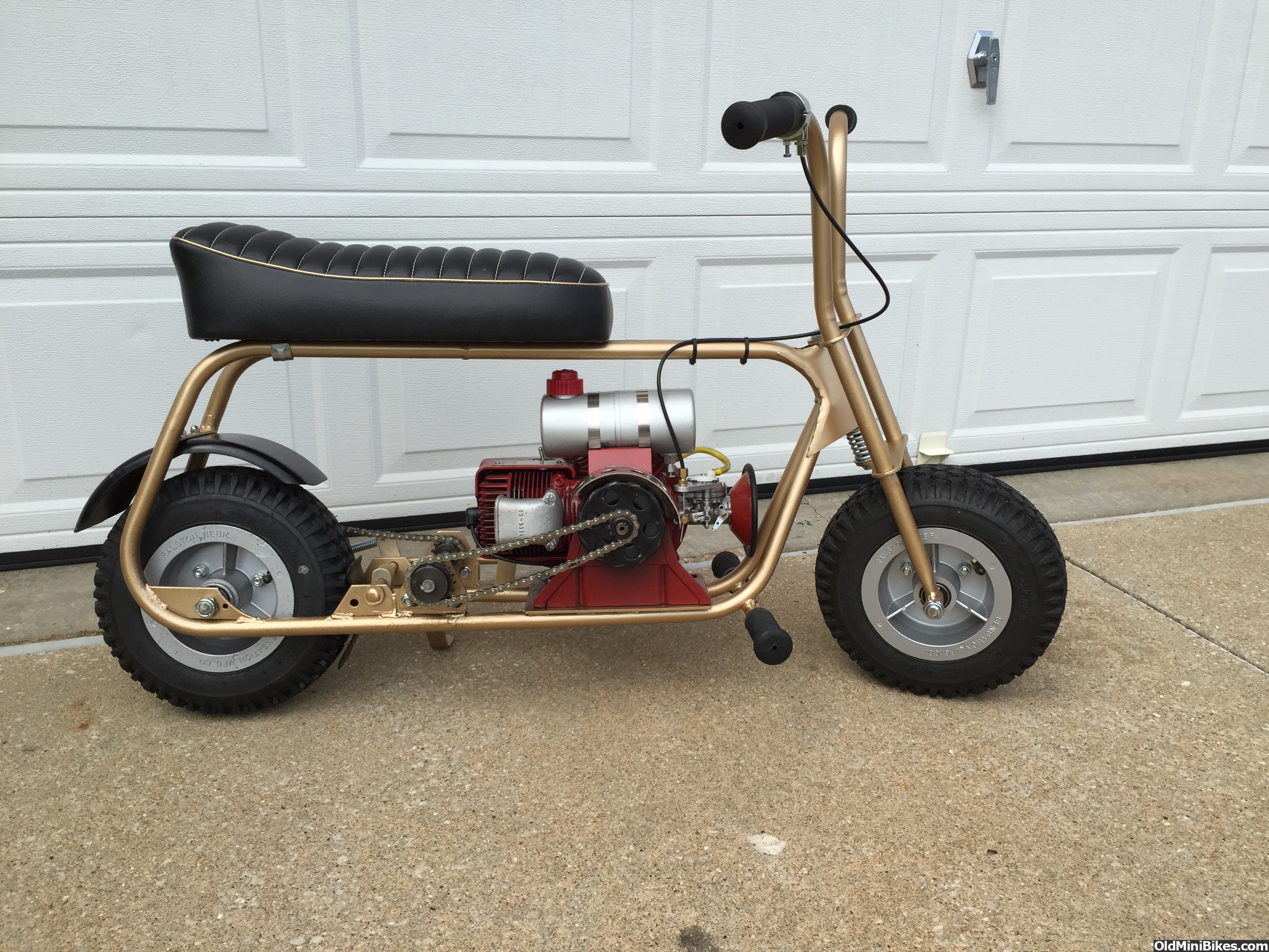

This is a Tecumseh Power Products Super 58 that I mounted into a sensation mini. I cut 3" out of the height of the frame for looks. Not much torque for launch, but the sound and smell well makes up for it.
