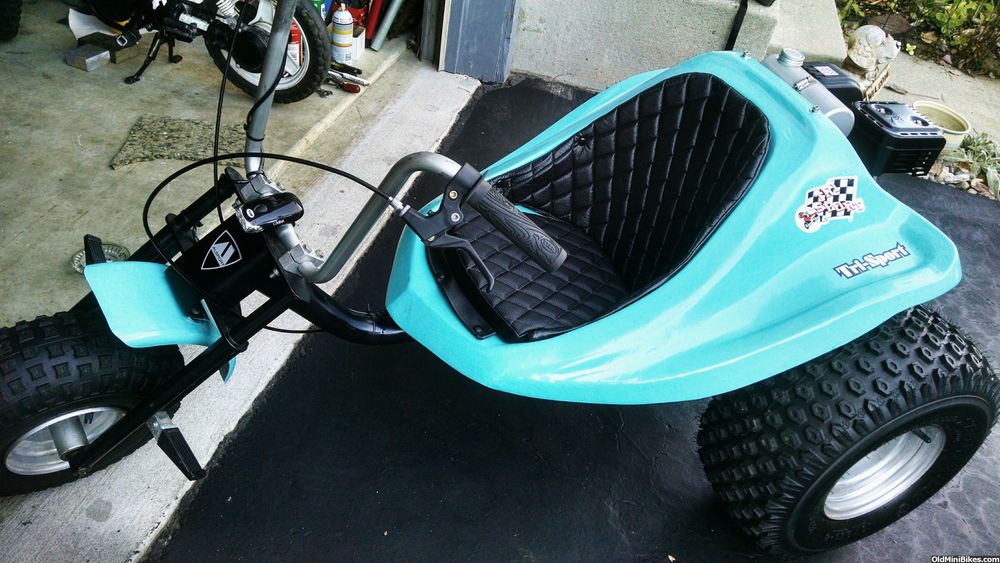

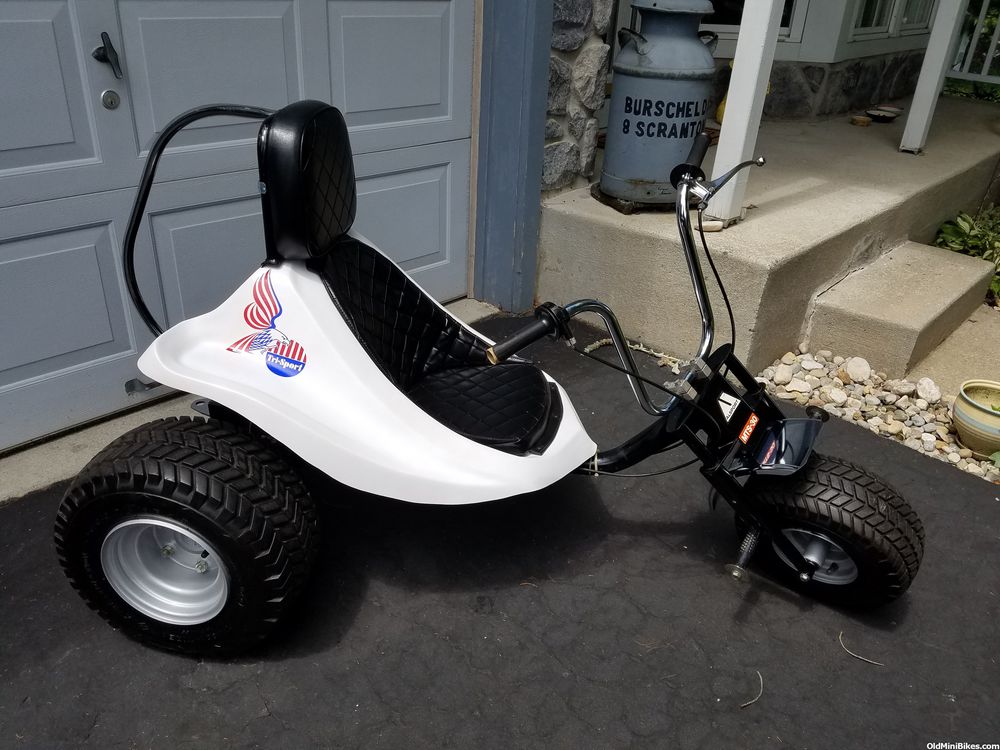

I saw that trike. What a great deal. Just too far for me to buy or I would of grabbed it. Check that the frame isn't cracked underneath where the engine is mounted. Both of mine was cracked in the exact spot. I might suggest replacing all the bearings and service the rear if you are going to ride it all the time. You will be good for another 40 years.
