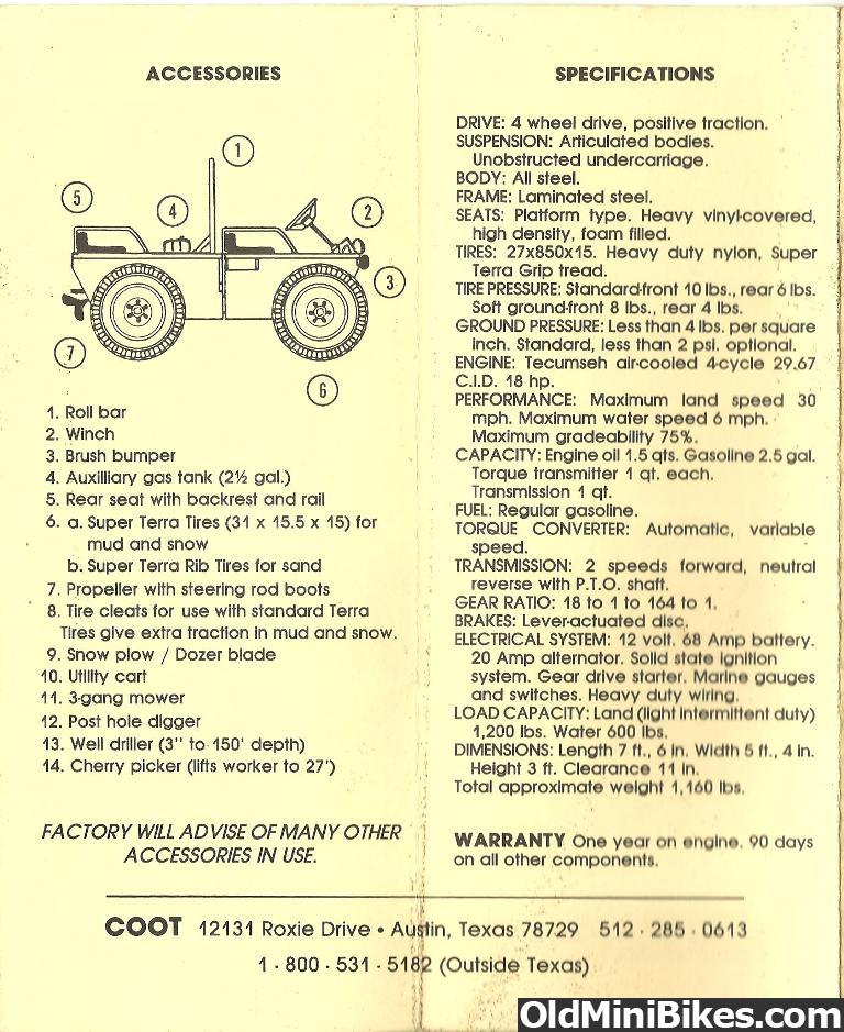

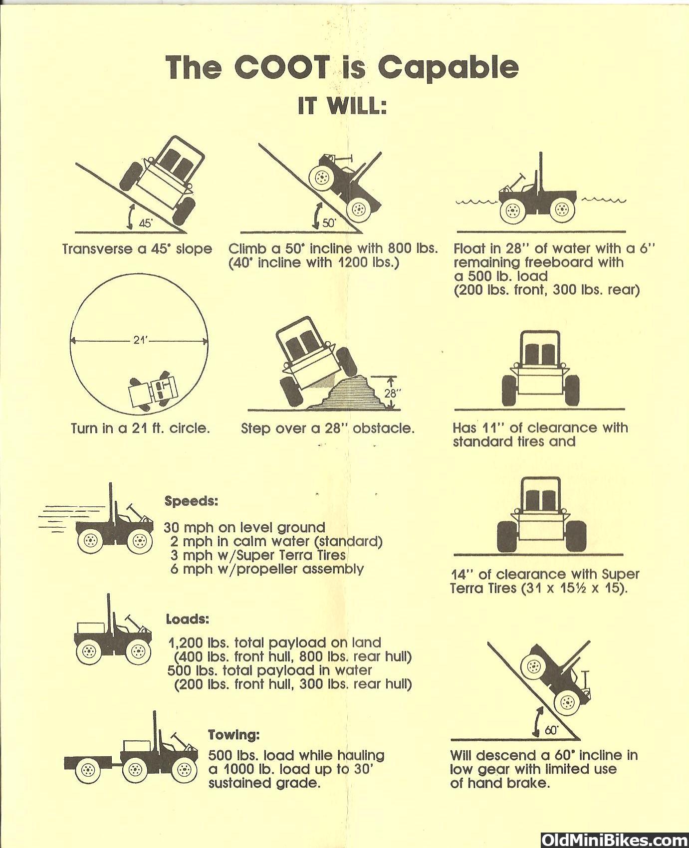

May not help much, but here is an old brochure I have for a Coot Industries Amphibious .....spec sheet shows an 18 hp 4 stroker Tecumseh....
(pages look better if you click on the yellow bar...)
