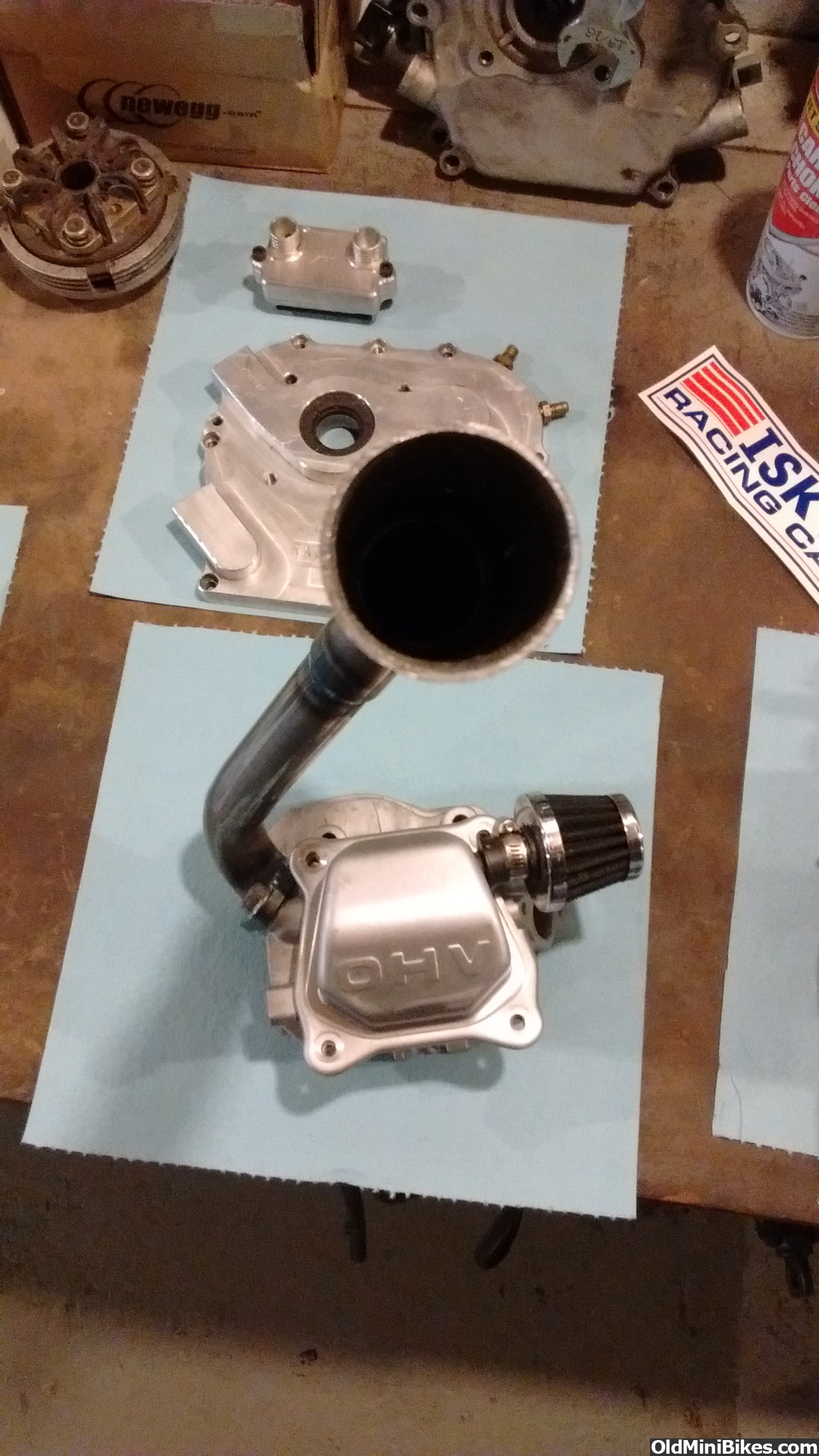

Okay this is what I'm doing.
No brace on my clone.
The brace on my raptor goes to the top of the head plus the two welded from the flang to the mid of the pipe.
Blockzilla yet to fab one up but I used some blue tape to give you an idea.
I use the lower hole on the head to brace my clone pipes not a great pic but you can see brace under the beginning of the exhaust. On a heavy pipe/long pipe you need a brace.
