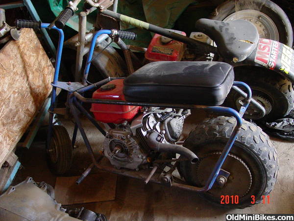

the hf 13 i got i put in a mb 165 had to do some work to get it in there right but its in there. As of the motor only thing that is stock is the the crank head and block. The crank i had cut down cause there to long cause the best clutch you can get is the noram enforcer and it only mounts on the end of the shaft and like said earlier it cost 200 bucks:doah: and i made the disk brake for it also that works great. but the hf 13 ive had great luck with its got tons of power you can wheelie it like a dirt bike and has enough power to slide it no prob. Ive been running it for a year now and ive turned it 8000 many times.
