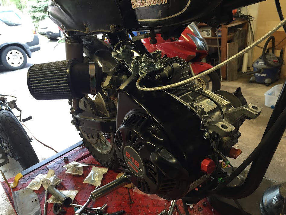

Here are some pics to go along with it. Was having issues with the the site allowing me to add them, then ran into a 5min time limit.
Intake
Exhaust
Clutch
Throttle
Here are a couple of it all finished

These questions came up in another thread, so I thought I would throw them up on here.
From an oil perspective, I overfilled the motor so that it was just shy of the full mark while at an angle. This ensured that the crank still had enough oil on it. It used about 3/4 qt of oil. I also left the low oil sensor in the motor as a safety precaution.
From a fuel perspective, I havent noticed any starvation issues. It may be worth building a custom intake manifold to flatten the carb out (and pull the filter toward the frame), but it doesn't seem necessary at this point. If I do go about this, i'll post up information about it.
