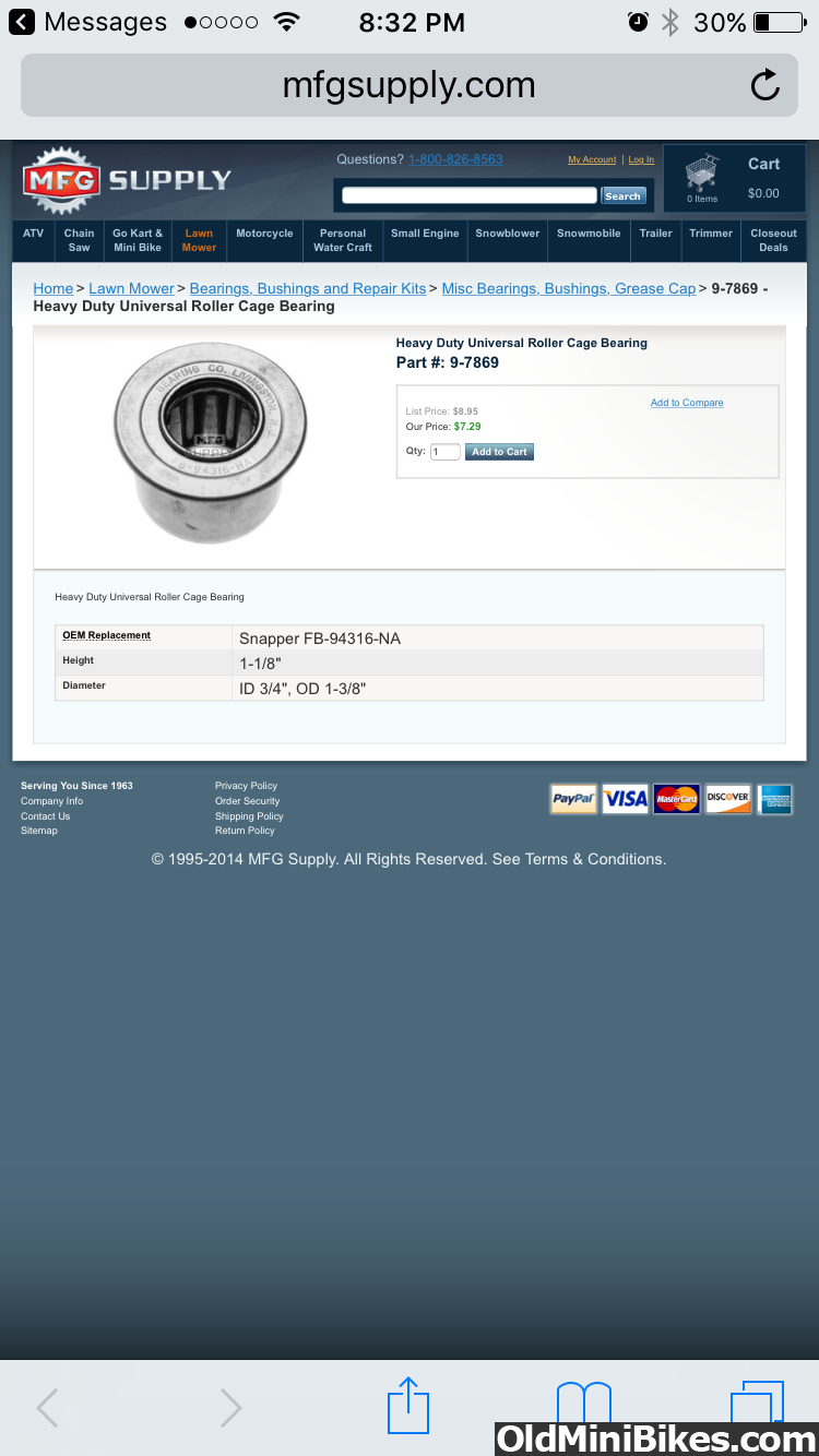

id go with the pillow block. the roller bearing will ride right on the shaft which is not hardened and dirt will get in there easier. probrobly wont last even as long as the ones you were using
Trike with the 18hp ate through the new bearings in two races... Moving up to appr. 25hp... Want to be ready
OK, thanks for the information and photo- To be the most helpful, it always helps to know the specific application. As others have already stated, go with the pillow block.
