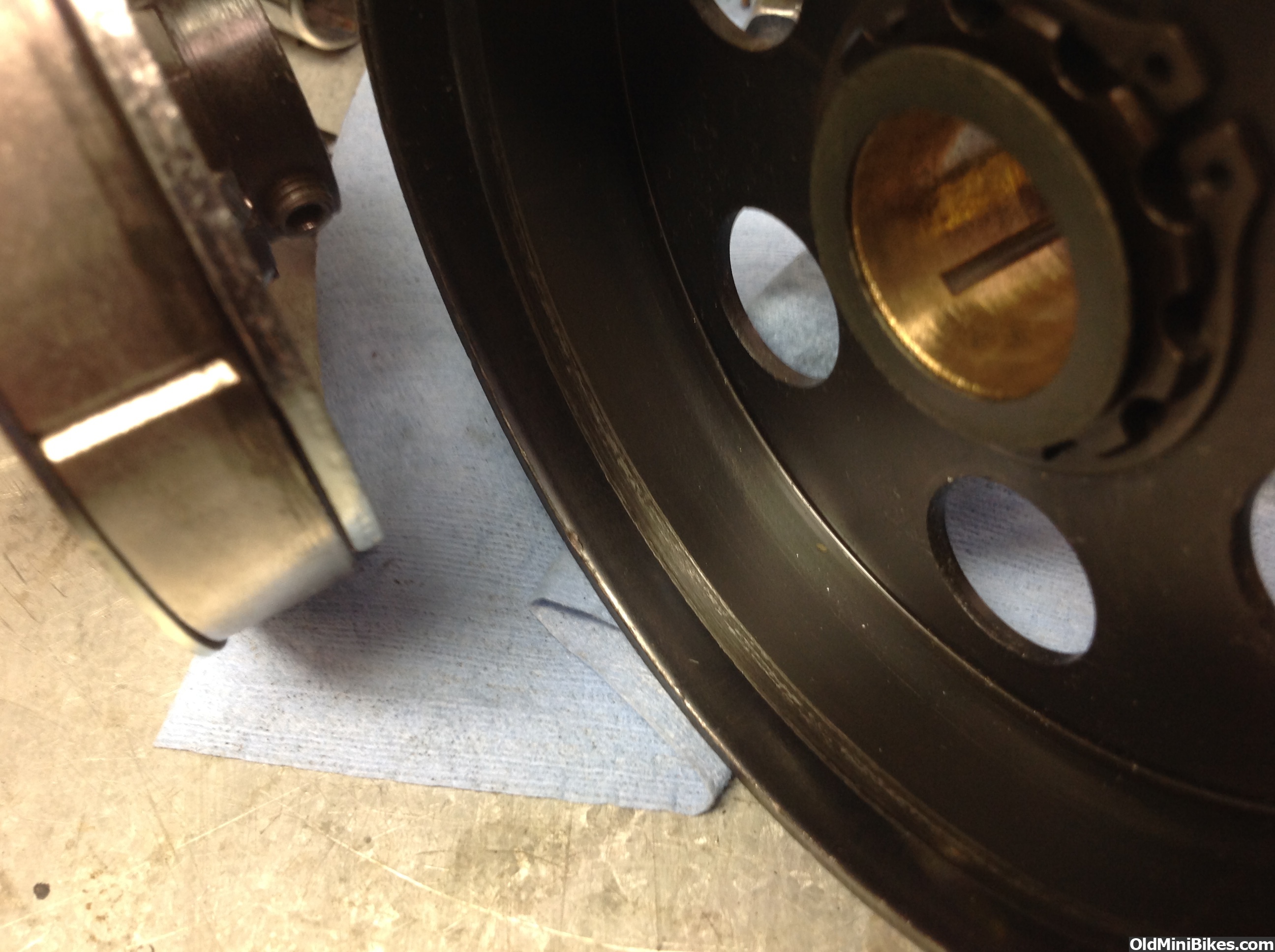

Hi Guys,
I disassembled the clutch that came on the mini I bought a while back and there is a groove 3/16 wide were the shoes engage the drum seems like the shoes should be in contact the full width of the shoe right? Not just the edge of the shoes, has anybody seen this is it normal or junk to be replaced? Previous owner claimed was a new clutch. Thanks

This is a groove that is worn in from the shoe as evident by the wear on the shoe, no other contact visible on the shoes

Thanks jeep, that is what seems to happening, the shoes are contacting crooked. I have since looked at a parts diagram and see that the garter spring sits in a slot on each shoe and could go to one side and have this result, won't last long I'm sure, looks like more $
Dear Old Enough, You can relax. The Max Torque clutch is designed so that only the inner one third of the shoes engages. You will always see wear on the inner part of the shoes and the rest of the shoe looks like it has never been touched. It does this to allow the shoes to engage smoothly instead of all at once. If the entire shoe surface area engaged all at once you'd experience a head snapping, wheelie popping, top fuel dragster type take off. Your clutch is fine. Ogy

Do you mean a groove is worn into the inside edge of the drum where the shoes make contact? Is it starting to slip? I've seen that on fun karts that are overloaded/geared wrong, smokes the clutch in no time.
Yes on the drum, looks like only 3/16 contact, thinking it should wear through in no time, have not finished the restoration and haven't rode it at all, 69 Taco 100. Bike had a predator in it when I got it.
That is not "normal" wear. I have never seen that with any of the Max Torque clutches we have owned.

Thanks Michael, that's what I had thought immediately when I saw it, as others have said its normal, I just don't know, even Max torques web site said that it engages to one side but to cause a groove surely is not right!
image.jpg I've only seen wear like that on a clutch that was being used on a yard kart with a 6.5 predator that was pushing 18" tires, that should have had a tc.
That's what I meant by smoked! Never seen it on a mini

After giving it much thought and the input from everybody, I am thinking the previous owner had installed the new clutch and had been driving around slowly and had never fully engaged the clutch like you or I would, what do you think about my theory?
capguncowboy
It's possible. It's also possible that the spring wasn't in the groove all the way. Was it the correct size or did it ride on top of the shoes?
